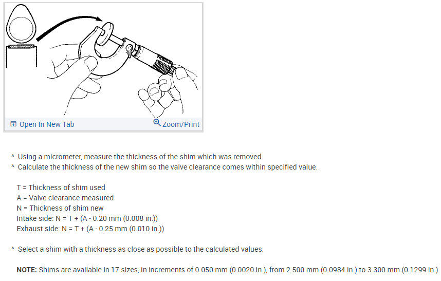

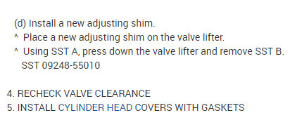

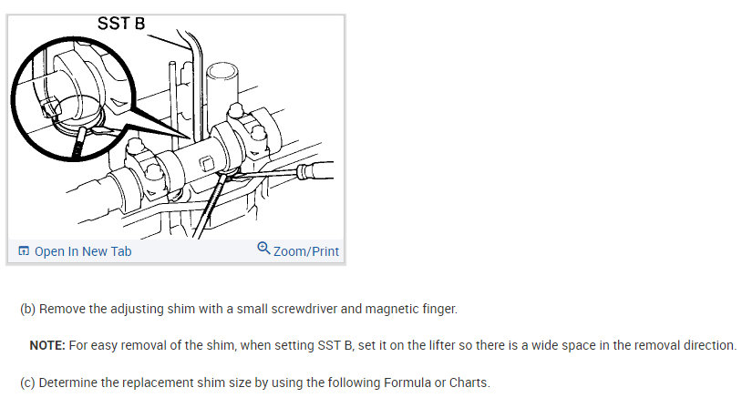

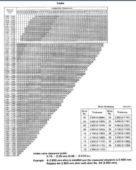

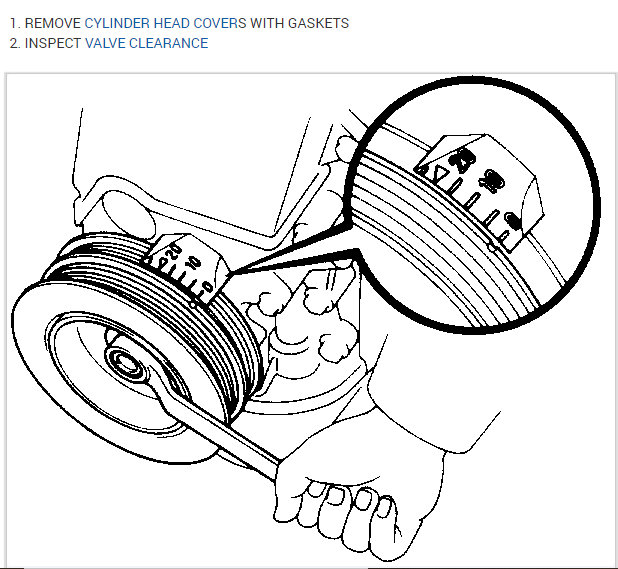

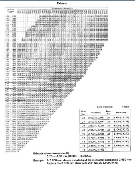

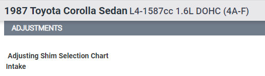

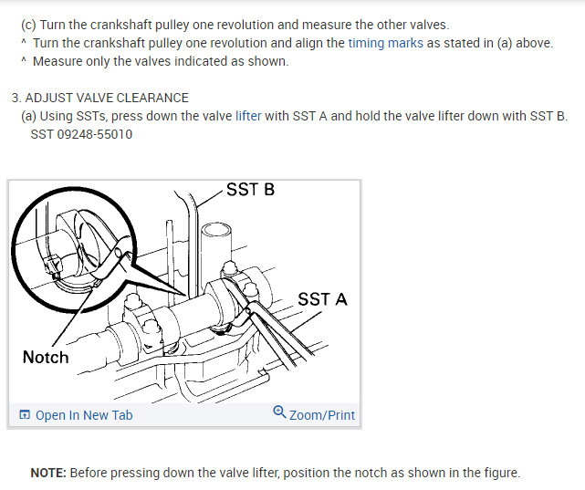

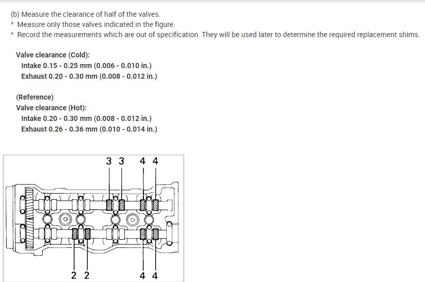

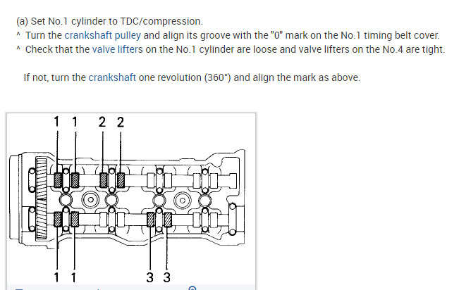

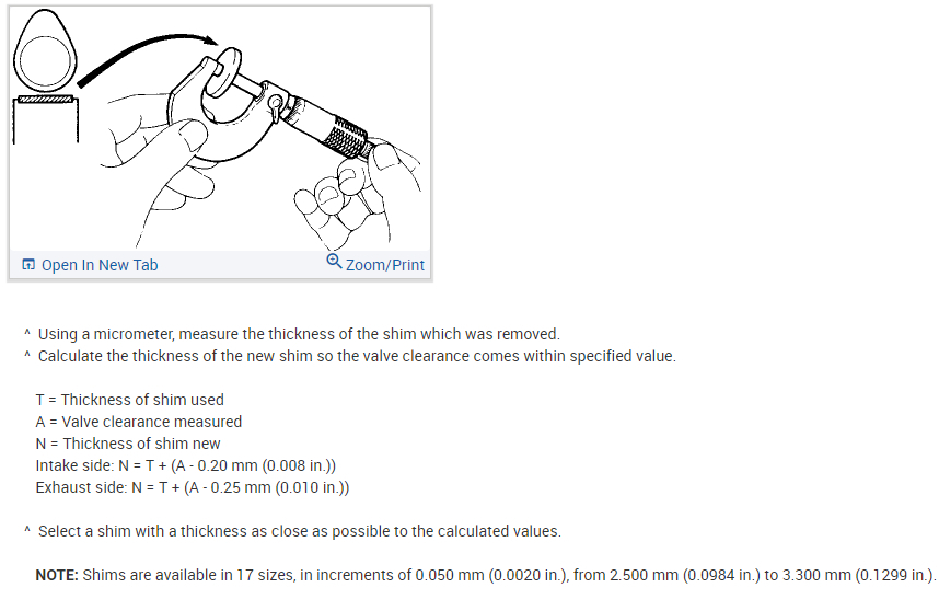

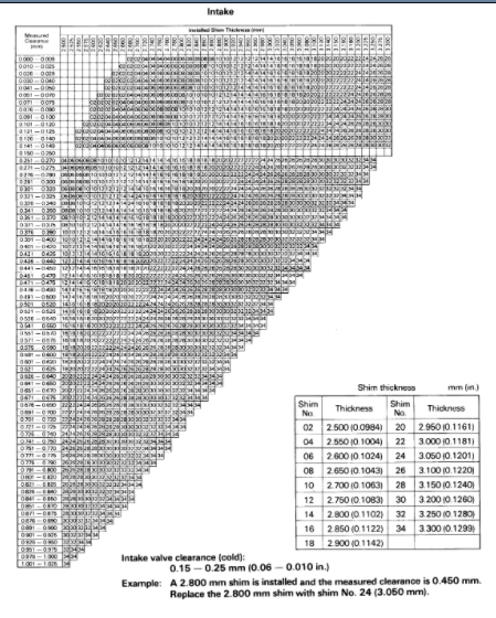

What are valve clearance values for 1987 Toyota Corolla (front drive, carburetor, 8 valves, OHC engine)? Cold or hot?
Jun 13, 2008 at 4:44 PM
DANNY L
  • CAR REPAIR CONTRIBUTOR
  • 5,648 POSTS

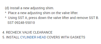

Hello, I'm Danny.
Here is the information you requested. I've attached picture steps below for valve adjustments and repair on your car. Hope this helps and thanks for using 2CarPros.
