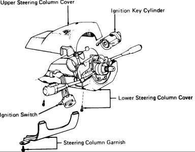

how do i change the key switch out,85 toyota corolla?

Hi kelli schreffler, Welcome to 2carpros and TY for the donation Fig. 7 Steering column & ignition switch assembly. Exc. 1984 Corolla
https://images.2carpros.com/forum/automotive_pictures/12900_ign_switch_1.jpg
Disconnect battery ground cable. Remove steering wheel, if necessary, steering column garnish, if equipped, upper and lower covers, Fig. 7. On Starlet models, remove upper cover. Disconnect electrical connectors from ignition switch. Turn ignition key to ACC position and remove ignition key cylinder. Remove screw and ignition switch. Reverse procedure to install.
