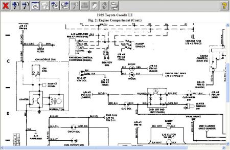

hi thanks for trying to help car will not get spark to sparkplugs I dont have battery voltage at the external ignighter clip

Check the ignition fuse also look for power at the black and orange wire at the coil positive and ignitor.
