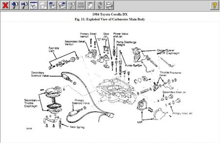

I need help installing a fuel filter?I don't know where it goes or what type of tools I need for the installation?

Hi there,
do you know which motor you have? can you post an engine code? It is stamped on the silver plate on the fire wall under Engine type.

its in the left front inner wheel area by the inner tie rod if the car is rusty you will never do it it has a 14 mil line you will need a 14mm line wrench as its bolted to the body 10mm bolts have fun

Only the EFI filters are this type, Carby filters are low pressure hose clamp type, there location can vary.

You have the 2bbl Asian Carb. At the carb follow it backwards to the fuel tank you'll run right into it. Liter could be 1.5L or 1.6L
https://images.2carpros.com/forum/automotive_pictures/12900_carb_1.jpg
