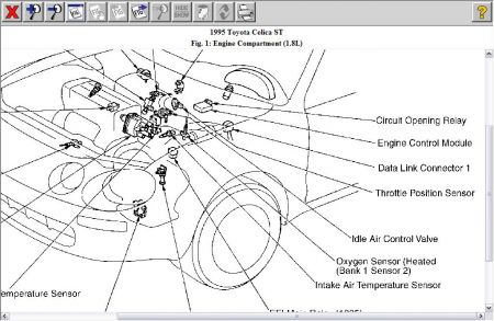

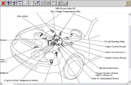

Ye I regret it now. Does the noises appear suddenly or after a while? Ive done it 2-3 times now.I have my music on loud so I cannot hear the engine. I am going to make sure I do not do it again.I get very paranoid :-P Oh yeah.I have another question if you can help? When my car is idol and has warmed up fully and the rev meter goes just below 1 rpm. My car begins to judder and the steering wheel vibrates too. Sometimes its quite bad and sometimes its ok. Would you know what this could be? Many Thanks, Your help is much appreciated.
Saturday, October 27th, 2007 AT 4:29 AM
  • 75,992 POSTS
You might consider a DIY major tune-up and go find the Idle Air Control Valve remove and clean it- See below
https://www.2carpros.com/forum/automotive_pictures/12900_IACV_1.jpg

https://www.2carpros.com/forum/automotive_pictures/12900_IACV3_1.jpg
