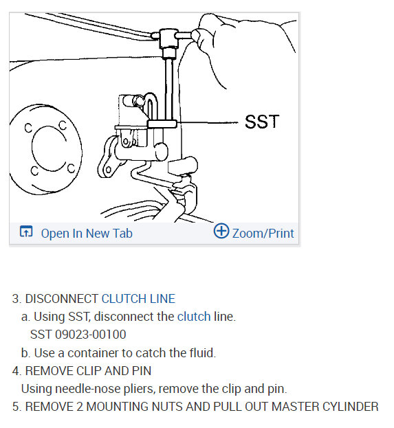

My 2002 toyota celica gts will not start when it is below minus 20 unless i constantly pump the clutch for a long time and press down as hard as i possibly can. It starts fine when i actually get it to connect, it is just trying to get it to that point. I am not sure if it would be just the clutch fluid since my car is from arizona and i now have it here in freezing canada. When it does start it makes a quich squealing noise too until it warms up a bit. Not even for a minute. Please help me! Even when i plug it in i still have this problem.

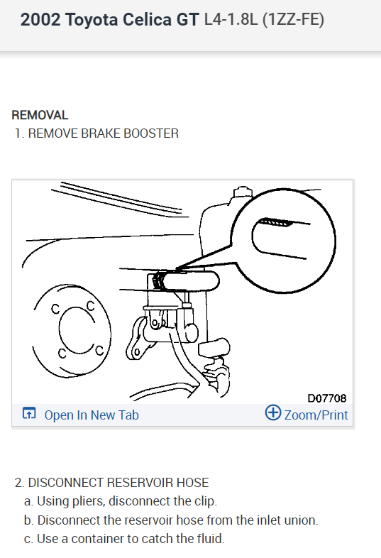

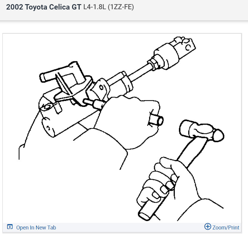

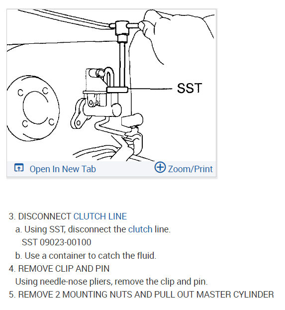

It seems like the clutch master cylinder is bad, but I would try flushing the fluid to see if that helps. Also, please go over this video:
