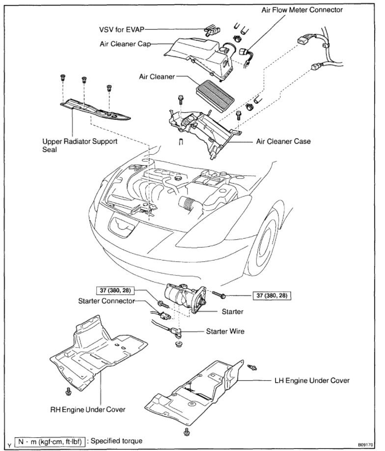

Where is the starter located and how to replace it.

The starter is on the side of the engine toward the front of the car. You will need to jack the car up to change it.
and this will give you an idea on what you are in for when doing the job
Here is a diagram (below) on what its on your car.
