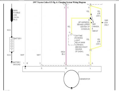

Electrical problem 4 cyl Front Wheel Drive Manual 183000 miles
I replaced alternator and housing for three pronged wiring set crumbled. I looking for wiring diagram to place each prong in right place while part is ordered. Thanks![img:85097df88f]http://www.2carpros.com/forum/automotive_pictures/398357_029_1.jpg[/img:85097df88f]

Hello –
To better assist you is your model the ST or GT and please tell me your engine size in liter…
Aug 19, 2009 at 10:50 PM
SPEAKLIFE
The Celica is a GT with a 2.2 ltr
Aug 20, 2009 at 12:51 AM
IMPALASS
  • 3,112 POSTS
Hello - Thanks for the info..................here is what we have...............
https://images.2carpros.com/forum/automotive_pictures/248015_alternator_2.jpg
Aug 20, 2009 at 9:21 AM
SPEAKLIFE
Thank you guys, that was exactly what I was looking for! The car started up no problem! I will definitely pass on your help and expertise to others!

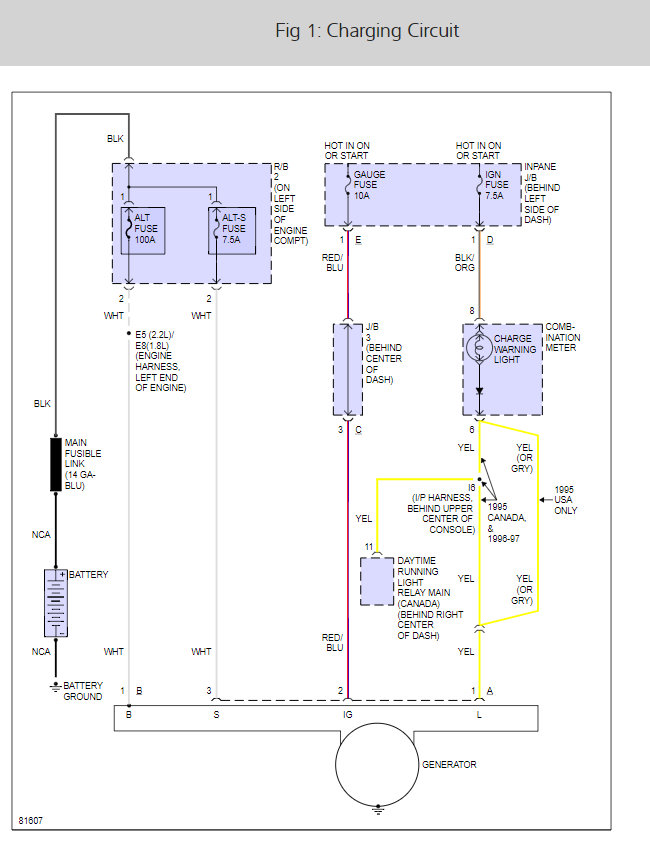

CHARLES MICHAEL TARVIN
Would this apply to a 1995 of the same specs? If so would the yellow wire be towards the front of the car?
Mar 17, 2018 at 6:50 PM
  • 54,840 POSTS
Here is the wiring diagrams for the alternator for your car (below)
