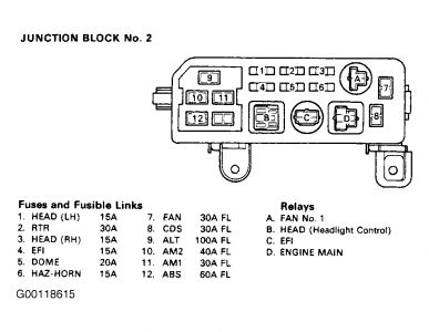

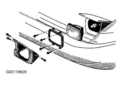

i'v obtained a new head light for my celica and would like to know how to remove the old one and refitt the new one,any help please
Oct 16, 2008 at 9:24 PM
2CARPRO JACK
  • 11,533 POSTS
Raise the headlights and turn off the lights with the doors raised.Then remove the RTR fuse (ee pic)

Remove screws holding on ornamental molding and remove it, then remove the screws for the light retainer and remove the reatainer and light together, unplug it when you have enough room to get to the plug.
