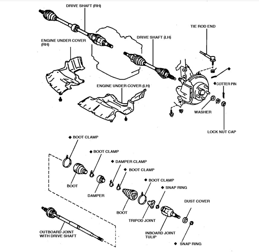

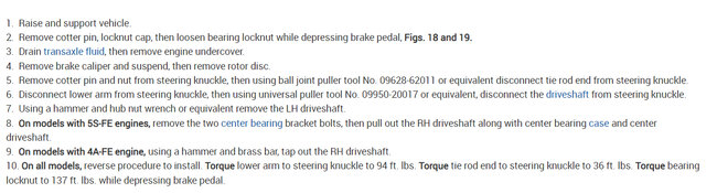

To me it sounds like the CV axles are worn out, here is how to change them out, when they get worn the CV joints do not work smoothly which causes the vibration.
Please go over this guide as well to get more information.
https://www.2carpros.com/articles/symptoms-of-a-bad-cv-axle-joint
Here is a generic guide to help you step by step with instructions in the diagrams below to show you how on your car.
https://www.2carpros.com/articles/replace-cv-axle
