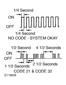

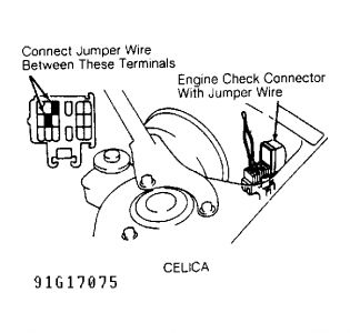

First thing is to see if there are any codes stored in the computer.Thisis done with asmall jumper wire inserted between 2 terminals int he diagnostic connector located under the hood (see pic)

Turn key on and count the flashes of the check engine light,teh light will flash with short intervals then long ones, with 21/2 second intervals between codes (see pic)

Hi, No I didn't get the original Toyota Coil. The 2 that I had put on came from Advance Auto Parts Store. Okay, now I have a question. What is a Jumper Wire? And where do I get it from?

You can use a paper clip bent to a "U" shape, or a short piece of wire with some small spade terminals crimped at both ends. You want to short the diagnostic terminals to put the ECM in field service mode. This will display the error codes, and it is also used to set the mechanical timing, since it removes all computer advance from the ECM.
