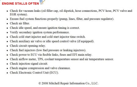

Hi tehkryptyk, Thank you for the donation. Problem seems to be idling related and not a starting problem. Can you keep the engine running with accelerator pedal depressed? If it is idling problem, here is a checklist.

Is the Check Engine Light indicating when engine is running?
What is the engine model code? 4AF-E ?
With air intake off and engine running at more than 2000 rpm, there would be a loud hissing noise as air is being sucked into the cylinders.
Standard resistance for test should be 19.3 to 22.3 ohms. Seems the specs is slightly out.

By disabling the MAP sensor, the ECM would provide backup data for running the engine so it would misfire at times.
Since vehicle is equipped with MAP sensor, any vacumn leakage should incerase the rpm and cause surging instead of stalling. The problem i most likely a faulty MAP.
