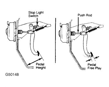

I have no brake lights. I have checked all the fuses and all of the bulbs and they are fine. Where do I go from here?

Check the stop light switch at the brake pedal arm. DISC & DRUM -1988 Toyota Celica ST Page 1 of 1 STOPLIGHT SWITCH Stoplight switch is located above brake pedal. See Fig. 1 . To adjust, remove panel and air duct (if necessary). Loosen lock nuts and turn switch until it touches pedal stop. Tighten lock nut. Check pedal height and brake light operation. 9/9/2008
