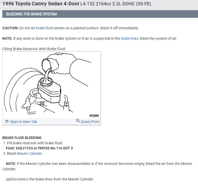

Hi, I have a 4 cyl, 96 Toyota Camry 260,000 km - with a brake compression problem - I've been told that the master cylinder requires replacement and the brakes bled.
If I pick up a Manual and the replacement parts, how difficult would this be for a not really mechanically inclined individual to do?
Thanks for any help / direction you can provide.

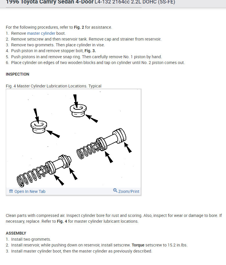

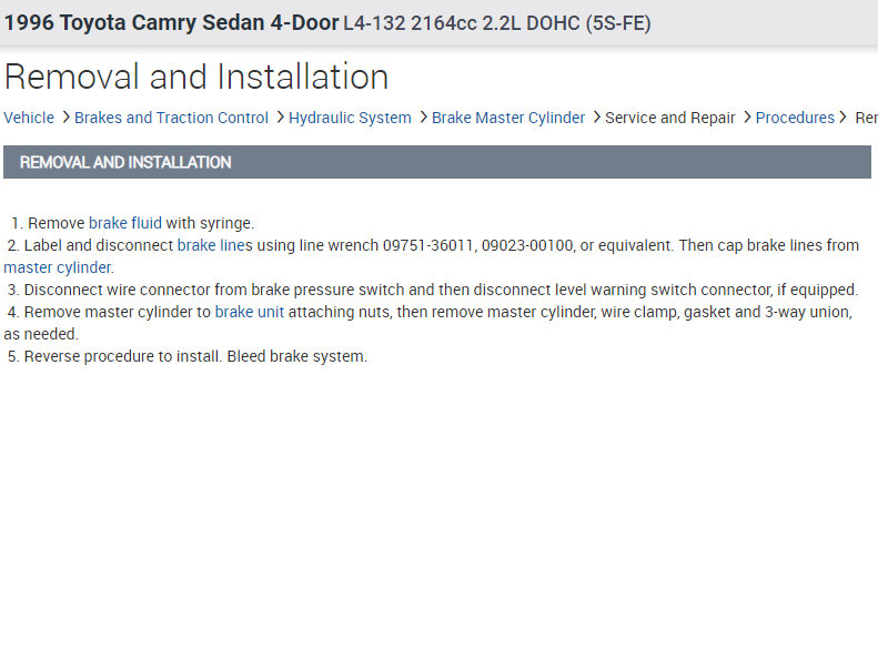

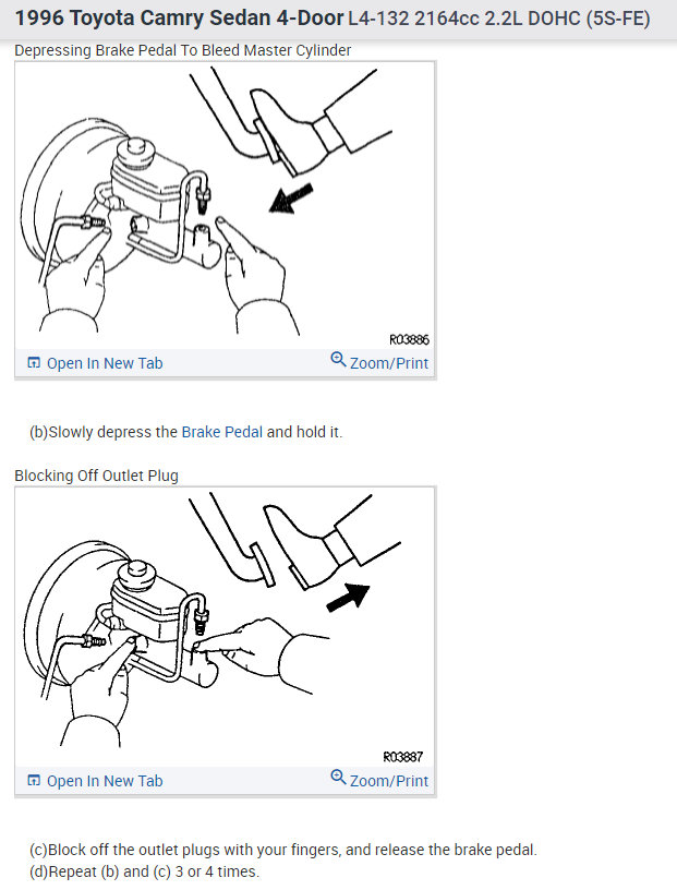

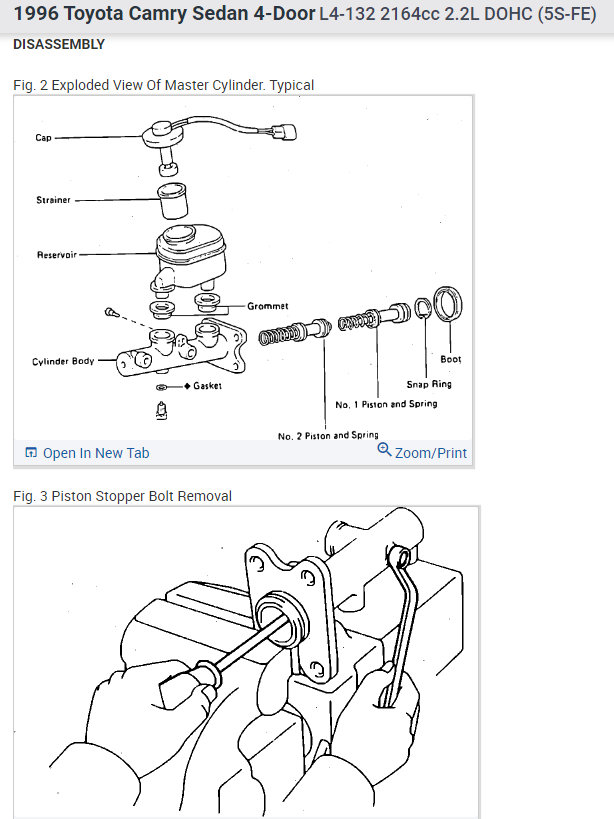

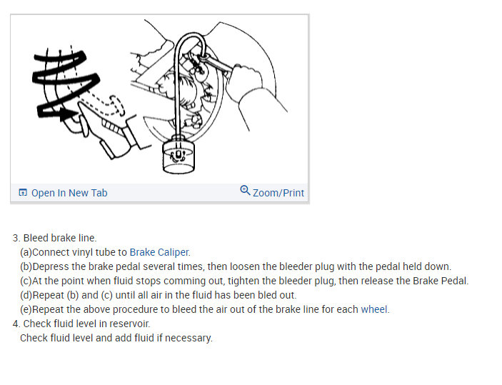

Replacing the master cylinder and bleeding the brakes are fairly straight forward process. It can be done in a relatively short period of time depending on your comfort level.
Keep in mind that brake fluid is corrosive and can be irritant to skin. So, it is ideal to wear safety glasses and latex gloves.
Before removing the master cylinder, you will have to get all of the fluid out of the reservoir, you can use a syringe to do that.
Here is a helpful article on master cylinder replacement:
https://www.2carpros.com/articles/how-to-replace-a-brake-master-cylinder
After installing the new master cylinder, you will have to add brake fluid and bleed the brake system for any air that could have gotten trapped.
https://www.2carpros.com/articles/how-to-bleed-or-flush-a-car-brake-system
I have attached the replacement procedure and brake bleeding procedure below.
