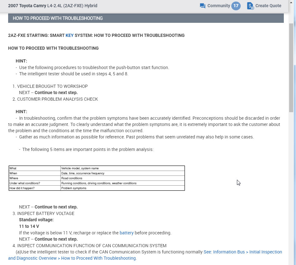

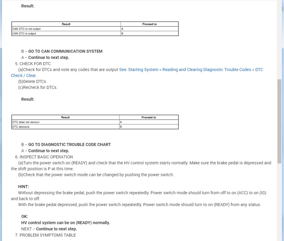

We need to start with what codes are in the system. More than likely there are some codes that will point us in the right direction. At this point the only thing that we can go on is a possible smart key issue.
When you press the key, does it cycle through the key position of ACC, On, Off?
Let me know what you find and we can go from there. Thanks
