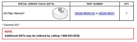

I have a new canister type filter that you only replace the filter material inside. I had the first oil change done at an oil change place. I tried to remove the filter using using the cannister filter wrench that grips it on the outside, using a scoket filter remover, that slipped. is there a screct to removing the filter container on a Camry. Thanks

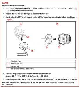

Is your oil filter wrench looks like below-its a special tool for your yr/model
https://images.2carpros.com/forum/automotive_pictures/12900_sst_1.jpg
https://images.2carpros.com/forum/automotive_pictures/12900_sst1_1.jpg
Engine - Oil Filter Cap Assembly Precaution T-SB-01 04-09 April 10, 2009 Oil Filter Cap Assembly Precautions Service Category Engine/Hybrid System Section Lubrication Market USA Applicability TSB SUPERSESSION NOTICE The information contained in this TSB supersedes TSB No. T-SB-0332-08. ^ Applicability has been updated to include 2009 - 2010 model year Highlander, 2010 model year Camry, Corolla, Matrix, Sequoia, Tundra, and 2009 model year Venza vehicles. ^ The SST table has been updated with an illustration. ^ The Notice in the Repair Procedure has been updated with a Figure and torque specification ranges to clarify SST usage. TSB No. T-SB-0332-08 is Obsolete and any printed versions should be discarded. Be sure to review the entire content of this service bulletin before proceeding. Introduction To prevent damage to the oil filter cap assembly this procedure must be closely followed during oil filter replacement to avoid immediate and future oil filter serviceability concerns. The following engines are equipped with a plastic oil filter cap assembly: ^ 1UR-FE (Tundra Sequoia) ^ 3UR-FE (Tundra Sequoia Land Cruiser) ^ 2ZR-FE (Corolla Matrix) ^ 1AR-FE (Highlander Venza) ^ 2AR-FE (RAV4 Camry) Warranty Information Required Tools & Equipment Repair Procedure Refer to the Technical Information System (TIS) when replacing the oil filter applicable model and model year Repair Manual:
