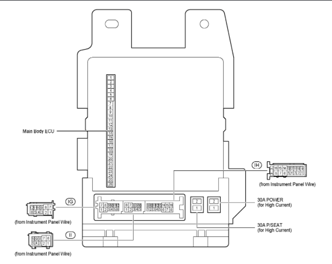

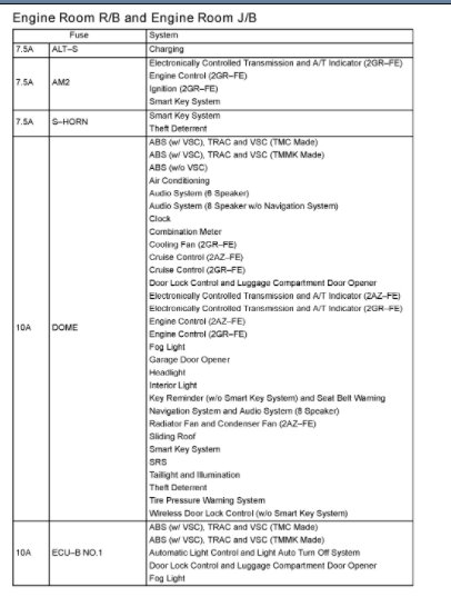

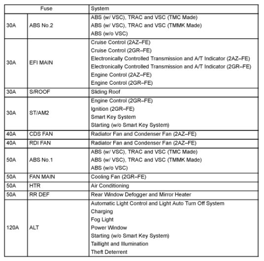

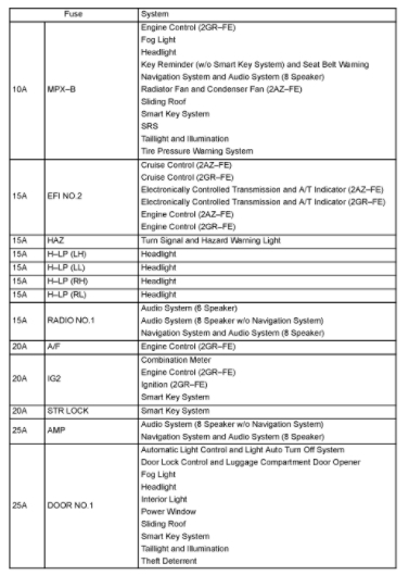

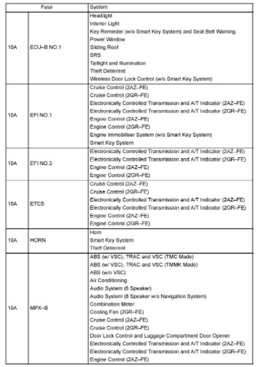

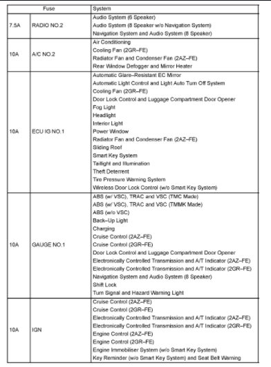

What tools do I need to check the fuses and where are the panels located?
Tuesday, February 16th, 2010 AT 11:15 AM
DANNY L
MECHANIC
5,648 POSTS
Hello, I'm Danny.
Here is the information you requested. Here are a few tutorials for you to view on how to check and replace fuses:
I've attached pictures below showing the fuse and relay locations on your car. Hope this helps and thanks for using 2CarPros.
