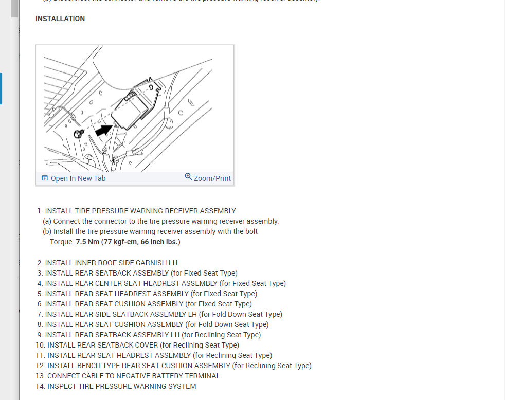

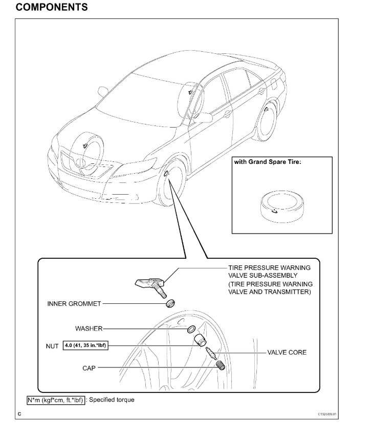

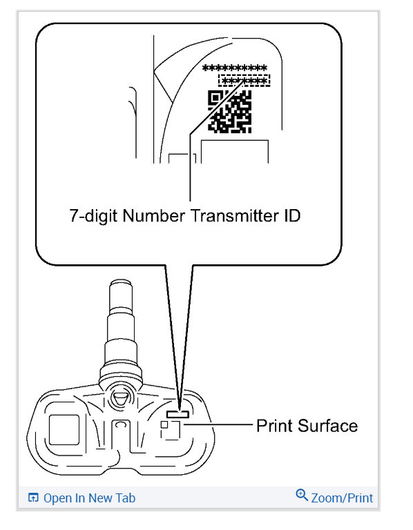

You probably have a tire pressure sensor that is not working here is how you find out which one with diagrams below to how to fix the problem.
TIRE PRESSURE MONITOR (TPM) SYSTEM
The Tire Pressure Monitor (TPM) system is designed to provide warning when tire inflation pressure of one or more tires (including spare tire) is low.
A tire pressure monitor valve sub-assembly containing a tire pressure sensor/transmitter is installed in each tire/wheel assembly. The sensor measures the internal tire pressure and temperature.
These measured values and transmitter ID(s) are transmitted to the tire pressure monitor receiver assembly on the body via radio waves.
This data is then sent to the tire pressure monitor ECU from the tire pressure monitor receiver.
If the transmitter ID has been previously registered, the ECU compares the measured air pressure value and the standard value.
When the value is less than the standard value registered in the tire pressure monitor ECU, the tire pressure warning light on the instrument cluster will turn on.
To accommodate the need to change the standard values recorded in the ECU when changes in operating conditions occur, or a different type of tire is installed, a tire pressure warning reset switch is provided. When activated, the current pressure values are stored in the ECU as the new standard values.
TIRE PRESSURE MONITOR WARNING LIGHT
When the tire pressure warning light does not go off, or when it comes on during driving, check tire pressure (including spare tire) and adjust as necessary. The warning light should go out within a few minutes.
If the warning light is still on even though the tire pressure is correctly adjusted, the tire could be punctured. Repair as necessary.
If the warning light is still on or blinks, after investigating all of the above, there is a malfunction in the TPM system. See appropriate manufacturer service information.

I saw that your car is a 2007 and I didn't see where anyone ask if the sensor batteries / sensors themselves have ever been replaced. Wheel speed sensor batteries last on average from 5 to 7 years, 10 at the longest. With that said your vehicles should have been replaced once, if not twice or more. I would have them tested to be sure they are transmitting properly if that hasn't been done yet. Should be a reasonably priced test.

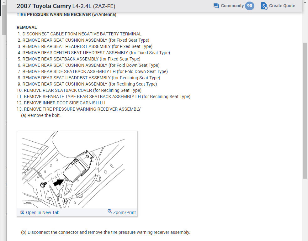

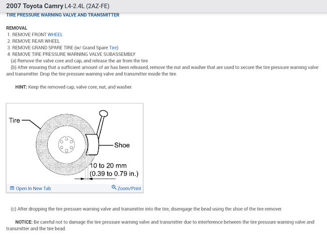

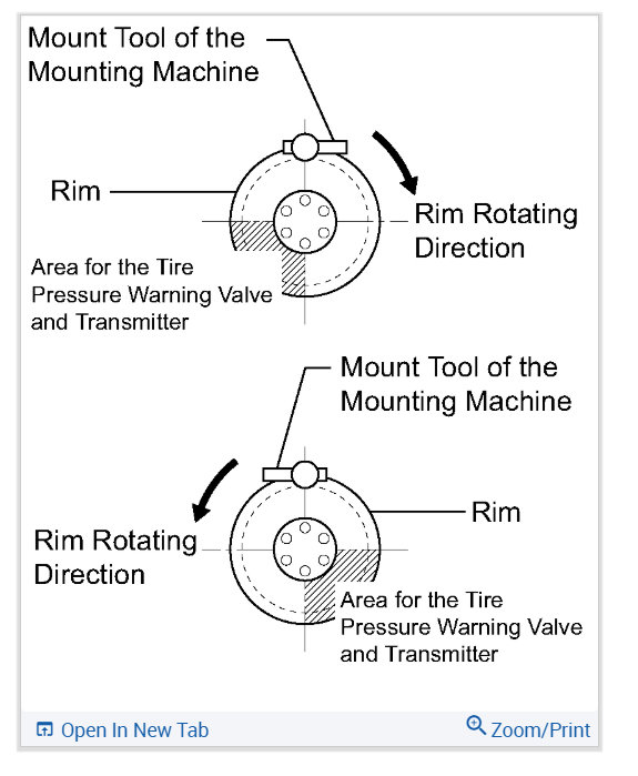

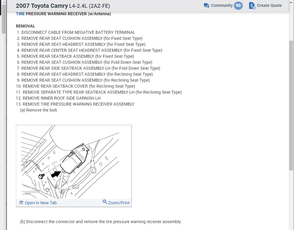

Not only a sensor issue but this is likely a module issue as well. The receiver that picks up these sensor signals often gets corroded and damaged.
I attached the info below on this in case someone else needs this in the future.
