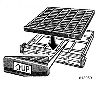

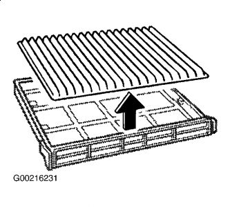

Remove filter from case
https://images.2carpros.com/forum/automotive_pictures/198357_Grafic_4_14.jpg
When installing new use "up" mark
https://images.2carpros.com/forum/automotive_pictures/198357_Graphic_5_8.jpg

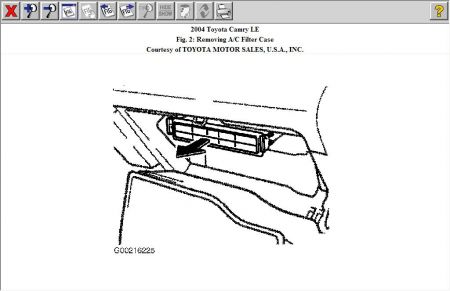

https://images.2carpros.com/forum/automotive_pictures/12900_2004_camry_cabin_air_filter0_1.jpg
https://images.2carpros.com/forum/automotive_pictures/12900_2004_camry_air_filter1_1.jpg
https://images.2carpros.com/forum/automotive_pictures/12900_2004_camry_cabin_filter2_1.jpg
https://images.2carpros.com/forum/automotive_pictures/12900_2004_camry_air_cabin_filter3_1.jpg
https://images.2carpros.com/forum/automotive_pictures/12900_2004_camry_cabin_air_filter4_1.jpg

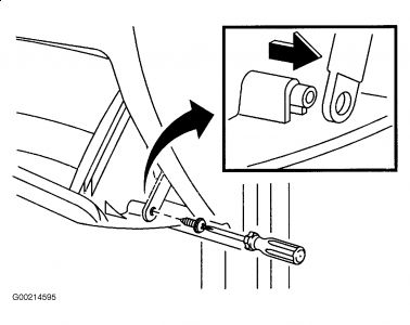

AIR CONDITIONING FILTER REPLACEMENT
https://images.2carpros.com/forum/automotive_pictures/12900_af_2.gif
1.Open the glove box. Remove the screw with a Phillips-head screwdriver and slide the hook as shown. 2.Push each side of the glove box to disconnect the claws. 3.Remove the filter case from the filter outlet as shown. 4.Remove the filter from the filter case. 5.Inspect the filter on the surface. If it is dirty, it should be replaced. Installation Reverse removal procedure.

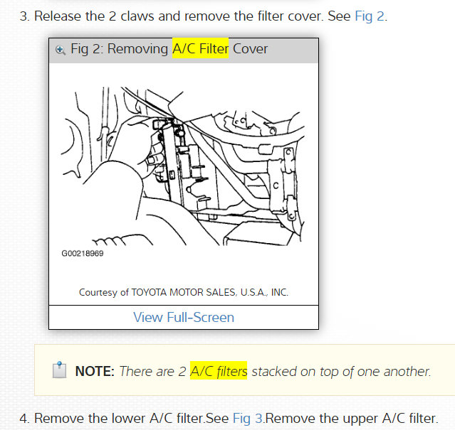

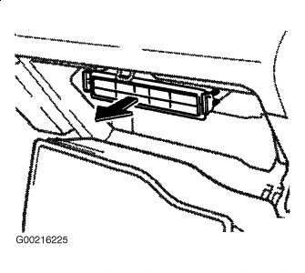

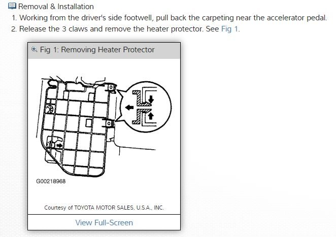

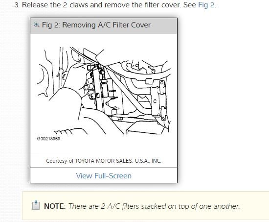

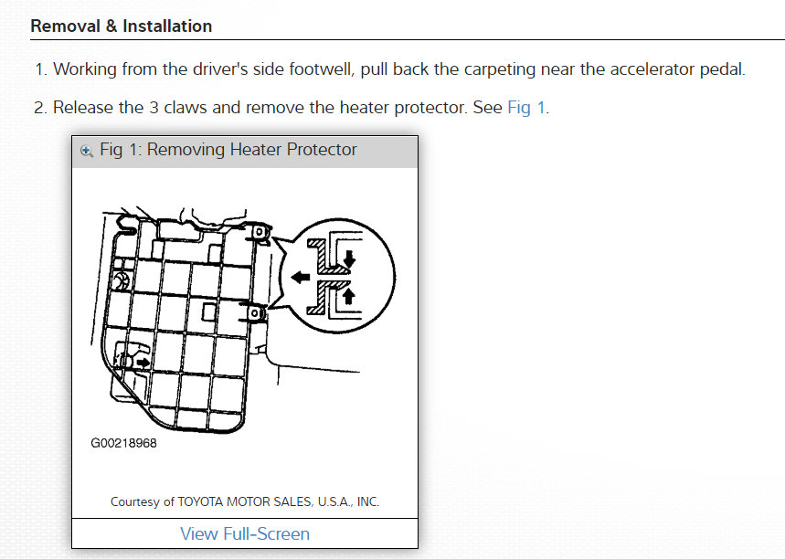

ZACKMAN
  • 4,202 POSTS

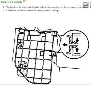

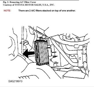

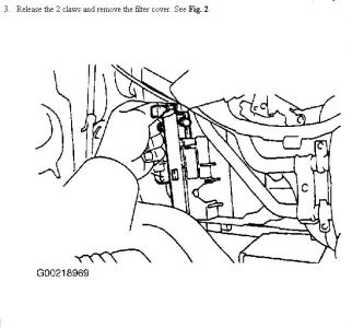

https://images.2carpros.com/forum/automotive_pictures/55316_97camrycabinfilter_1.jpg
https://images.2carpros.com/forum/automotive_pictures/55316_97camrycabinfilter2_1.jpg
https://images.2carpros.com/forum/automotive_pictures/55316_97camrycabinfilter3_1.jpg
https://images.2carpros.com/forum/automotive_pictures/55316_97camrycabinfilter4_1.jpg

CNA20086
where is the cabin filter located in my toyota camry 1998
Mar 10, 2021 at 10:16 AM (Merged)

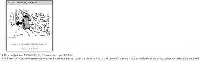

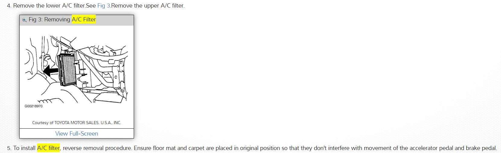

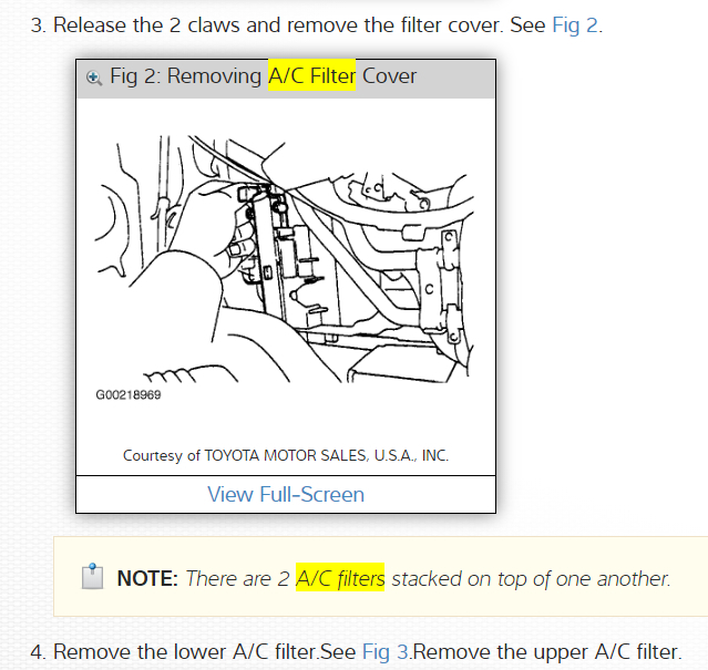

BLUELIGHTNIN6
  • 16,542 POSTS
The cabin filter is in the A/C evaporator housing which is located behind the center of the instrument panel. Below you will find some illustrations and a guide to help you find and change the filters
https://www.2carpros.com/articles/how-to-change-an-air-cabin-filter
