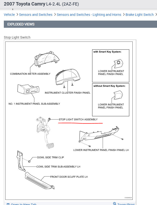

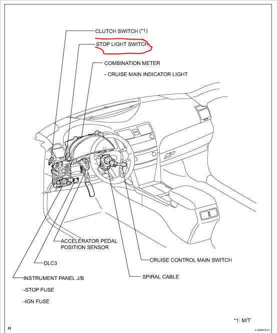

I need to replace a brake light switch in a 2007 Camry. I have located it but don't know how to get it out to replace it. I tried to mess with it with my hands but cant seem to get anywhere with it. How do I get that thing out of there??

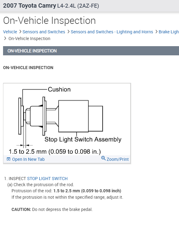

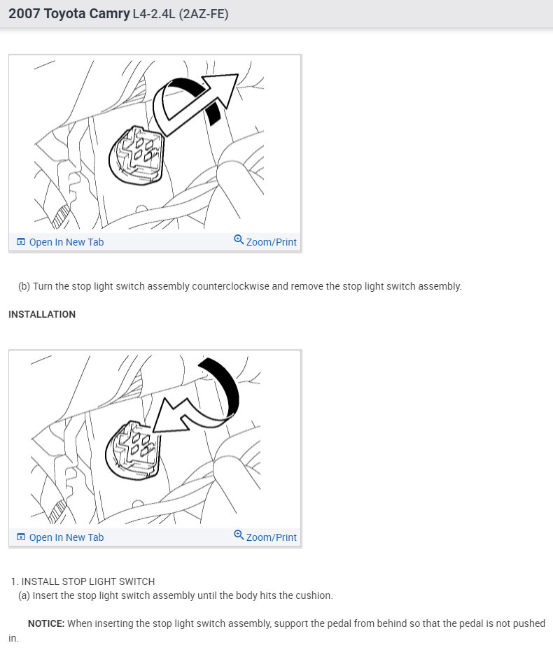

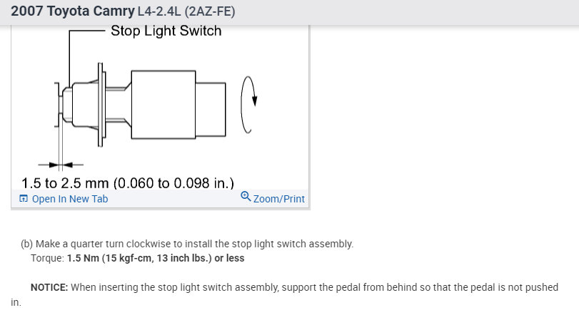

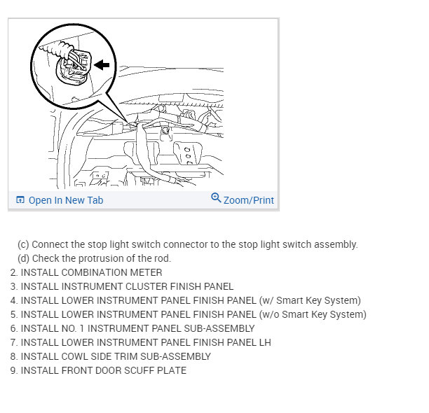

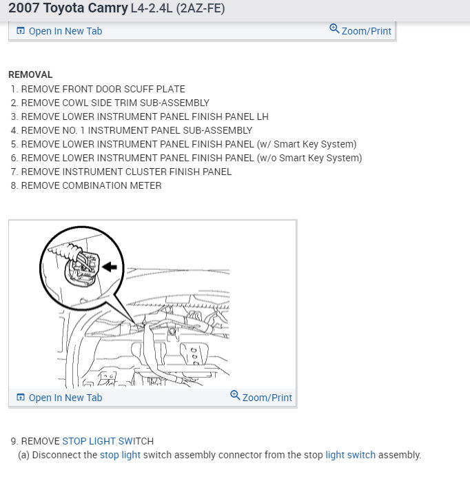

The brake light switch is located on the brake pedal lever. There are few items to remove before the switch can be replaced.
You might find this video helpful:
https://youtu.be/RBCDVfzNQGk
I have attached the replacement procedure below.
