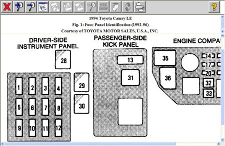

I want to now which one the brake light fuses.
Thursday, October 16th, 2008 AT 12:21 AM
3 Replies
MECHANIC
75,992 POSTS
Hi Mr. leo waxx the stoplight fuse is in the fuse block located in no.3 25amp fuse-see below and thank you for using 2carpros

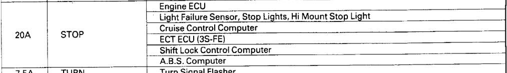

Rear running lights and brake lights not working.
+2
Thursday, March 11th, 2021 AT 12:09 PM (Merged)
MECHANIC
109,724 POSTS
Welcome to 2CarPros.
There is a 20 amp brake light fuse near the left kick panel.
Here are a few links you may find helpful:
Image (Click to make bigger)
