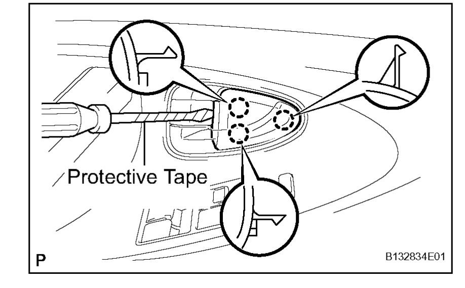

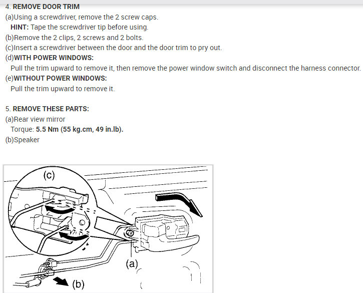

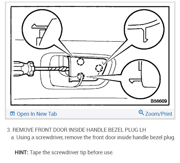

My Camry has 19,000 miles on it and I had to replace the original tires because they only had 4/32nds of inch treadwear left. I replaced the tires and now the drivers side window regulator needs to be replaced can you help me please?
Sep 10, 2008 at 12:23 PM
Good morning,
I attached the procedure below for you to remove the regulator for the window.
https://www.2carpros.com/articles/how-to-check-and-replace-a-electric-power-window-motor
Let me know if you have any other questions.

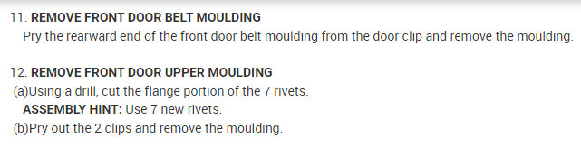

DISASSEMBLY

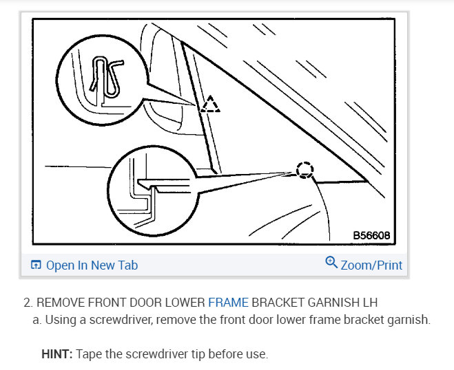

1. REMOVE FRONT DOOR LOWER FRAME BRACKET GARNISH
a. Disengage the 2 clips and remove the front door lower frame bracket garnish.

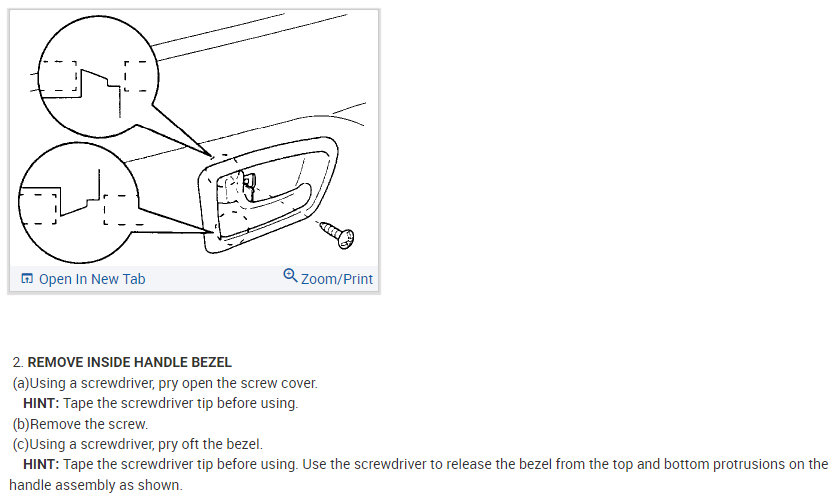

2. REMOVE FRONT DOOR INSIDE HANDLE BEZEL PLUG
a. Using a screwdriver with the tip wrapped with protective tape, disengage the 3 claws, and remove the front door inside handle bezel plug.

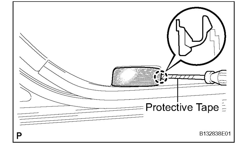

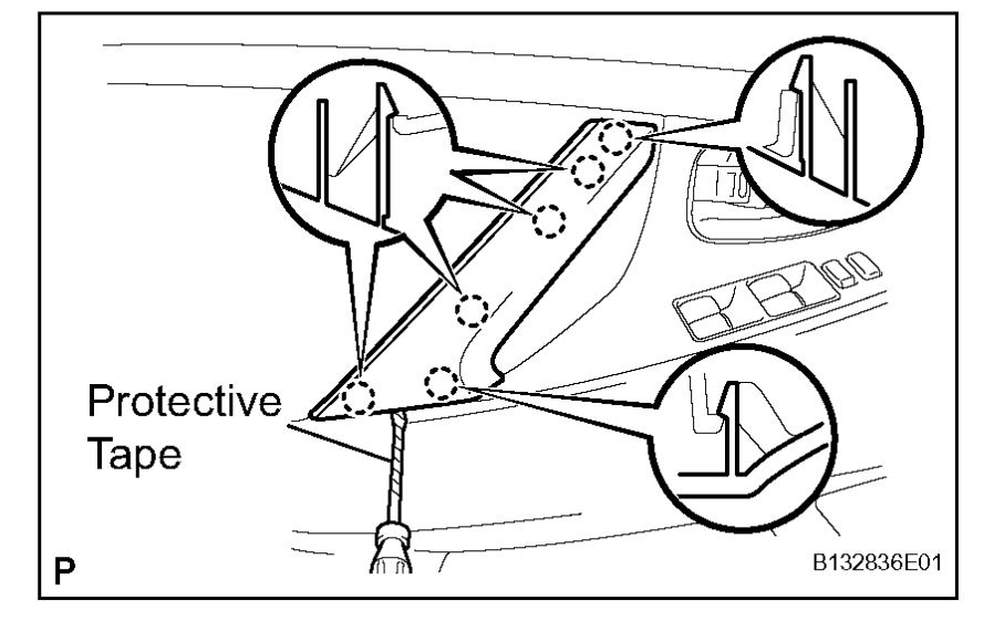

3. REMOVE ASSIST GRIP COVER
a. Using a screwdriver with the tip wrapped with protective tape, disengage the 6 claws and remove the assist grip cover.
4. REMOVE COURTESY LIGHT ASSEMBLY
a. Using a screwdriver with the tip wrapped with protective tape, disengage the claw and remove the courtesy light assembly.
b. Disconnect the connector.

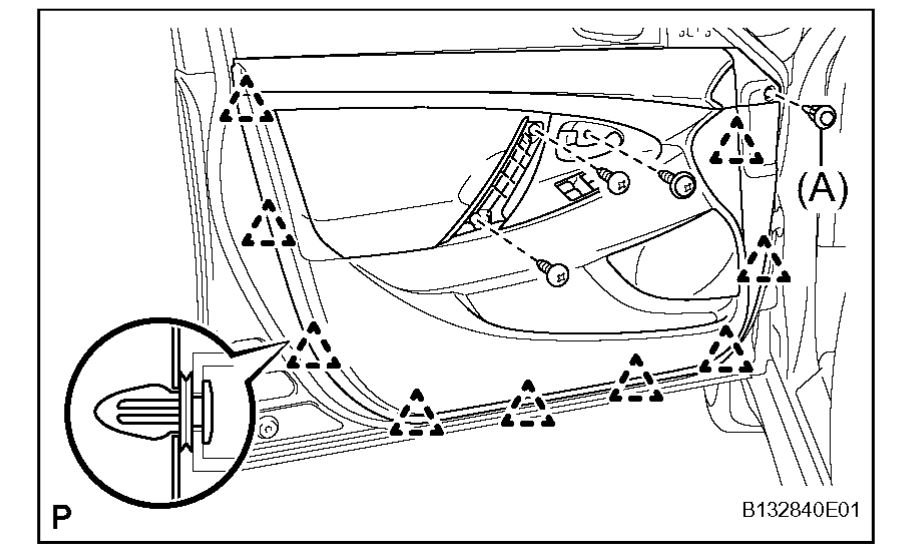

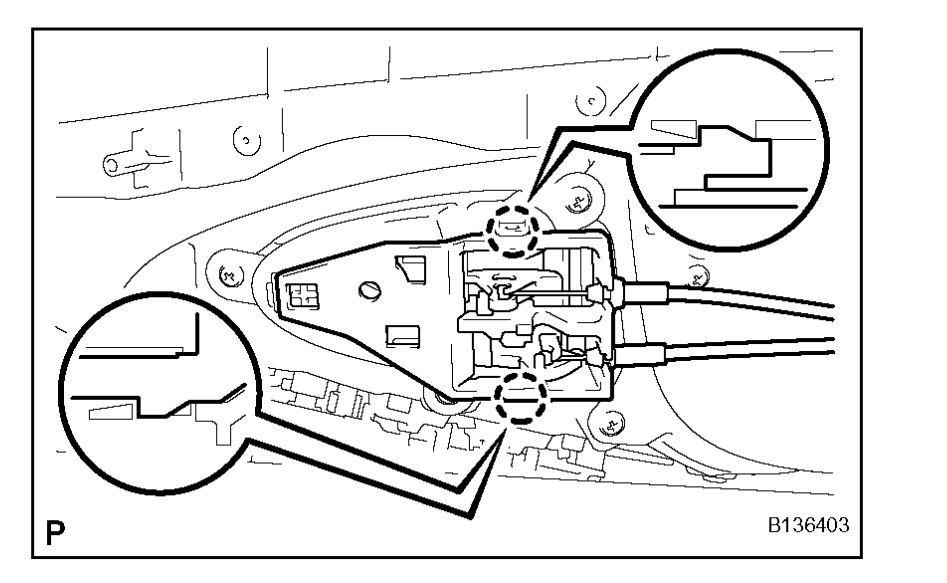

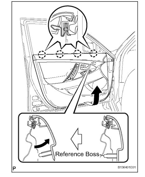

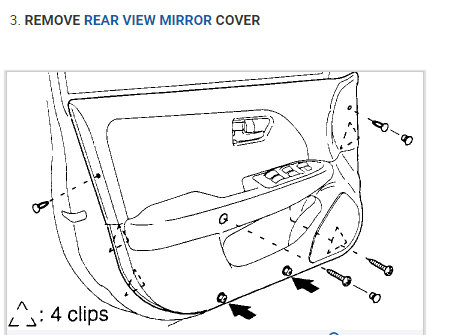

5. REMOVE FRONT DOOR TRIM BOARD SUB-ASSEMBLY
a. Remove the 3 screws and clip (A).
b. Using a clip remover, disengage the 9 clips.
c. Pull up the front door trim board in the direction indicated by the arrow.
d. Disengage the reference bosses from the front door panel.
e. Raise the front door trim board to disengage the 4 claws and remove the front door trim board together with the front door inner glass weatherstrip.
f. Disengage the 2 claws and disconnect the front door inside handle sub-assembly.

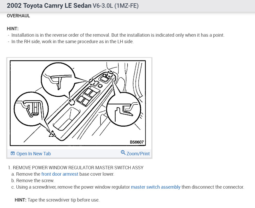

6. REMOVE POWER WINDOW REGULATOR MASTER SWITCH ASSEMBLY

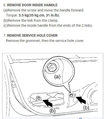

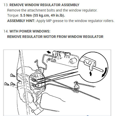

Need instructions for removal and reinstalling drivers side wimndow up/down motor and pulley 2000 cambry
Feb 19, 2021 at 11:13 AM (Merged)

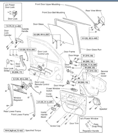

MATHIASO
  • 1,209 POSTS
Hello mesacapri there few steps before removing the regulator # Disconnect the negative battery cable. # Remove the front door panel to gain access to the regulator assembly. # Remove the service hole cover. # Lower the regulator until the door glass is in the fully open position. # Remove the two glass channel mount bolts.
https://images.2carpros.com/forum/automotive_pictures/46384_0996b43f80202aa1_2.jpg
# Pull the glass up and out of the door. # If equipped, unbolt and remove the inside door panel frame. Removing front door inside panel frame by removing these bolts and nuts
https://images.2carpros.com/forum/automotive_pictures/46384_g_1.jpg
If equipped with power windows, disconnect the electrical wiring. # Remove the equalizer arm bracket mounting bolts. # Remove the window regulator mounting bolts and remove the regulator (with the power window motor attached) through the service hole.
https://images.2carpros.com/forum/automotive_pictures/46384_0900c15280092ae7_1.jpg
To install: 11. Coat all the window regulator sliding surfaces with multi-purpose grease. 12. Place the regulator (with the power window motor) through the service hole and install the mounting bolts. Connect the power window connector if equipped. 13. Place the door glass into the door cavity. 14. Connect the glass to the regulator with the channel mount bolts. 15. With the equalizer arm, raise the glass to the almost closed position and make sure that the leading and trailing edges of the glass are equidistant from the top of the glass channel. If not, adjust the equalizer arm to achieve an even fit. 16. Install the service hole cover. 17. Install the door panel and reconnect the negative battery cable.

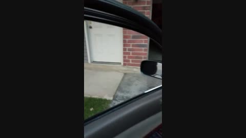

I can't seem to figure out how to upload a video. but the window makes a clunk when you start to open it almost like it is off track. I'll keep trying on the video it's not going to show much you might hear a sound when it makes its clunk but that's about it.
JEFF HERMAN
  • 486 POSTS
Here is a video It doesn't show much but maybe you can hear the jerk when I start to open it each time
  • 55,097 POSTS
Thanks for the video, yes this happens when the regulator is about to go out. here is a video of a window regulator being replaced on a similar car along with the instructions on how to replace your in the diagrams below:

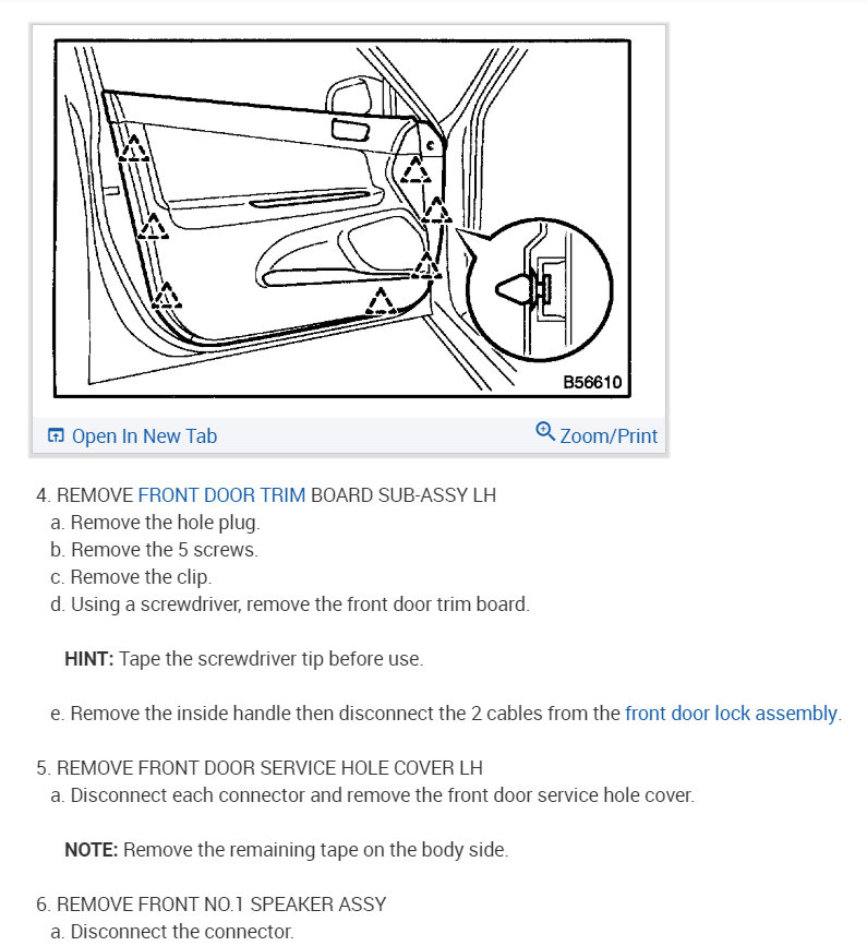

PITCREW94
  • 18 POSTS
You'll have to take out the door panel. There's about 7-9 10mm bolt.. 2 for the glass, 3 on the motor, 2-4 on the window reg. itself. Disconnect the window reg. wire.

GRSMNKY
  • 33 POSTS
totally not hard. first take off the inside plastic door cover, few screws, and don't forget to unplug the connectors for the window switch. remove the clear weather proof plastic, unscrew the window glass from rail(2 screws) and pull glass out as you turn it sideways. unplug the window motor connector, unbolt the regulator and motor assembly (few more bolts) from door frame and pull out the whole thing

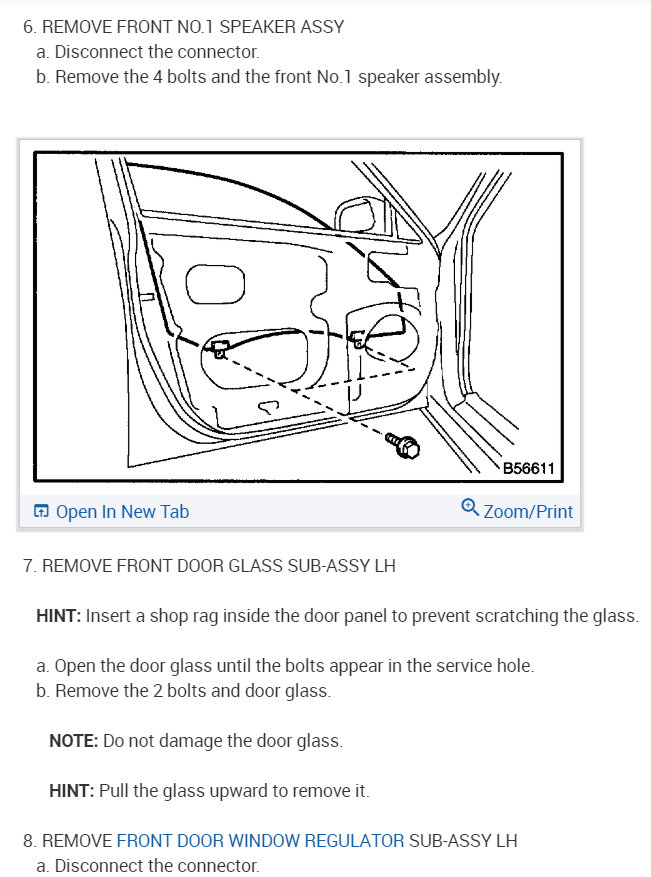

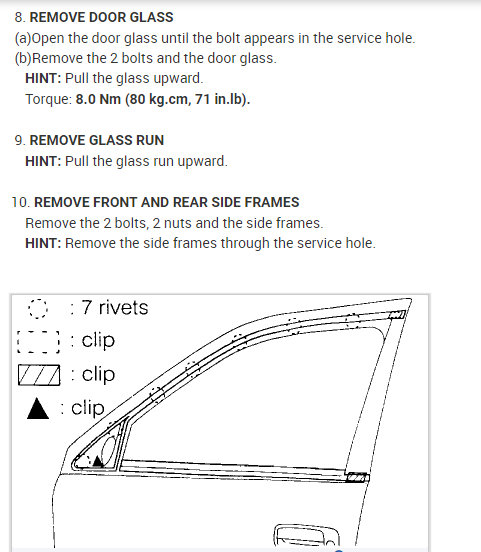

BLUELIGHTNIN6
  • 16,542 POSTS

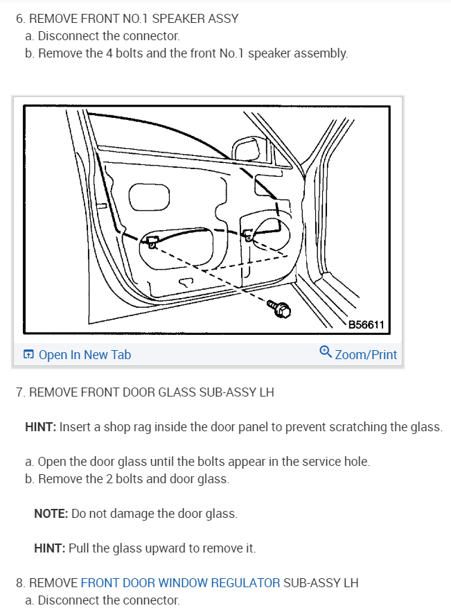

The power window motor is attached to the window regulator. If service is required, remove the window regulator from the inside of the door panel and detach the motor from the regulator
Feb 19, 2021 at 11:15 AM (Merged)

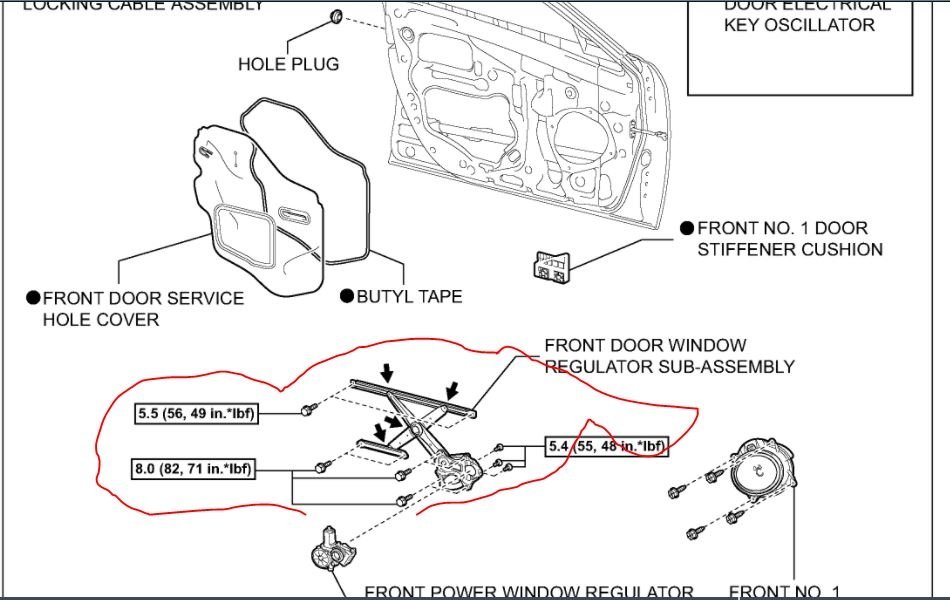

Hello, I'm Danny.

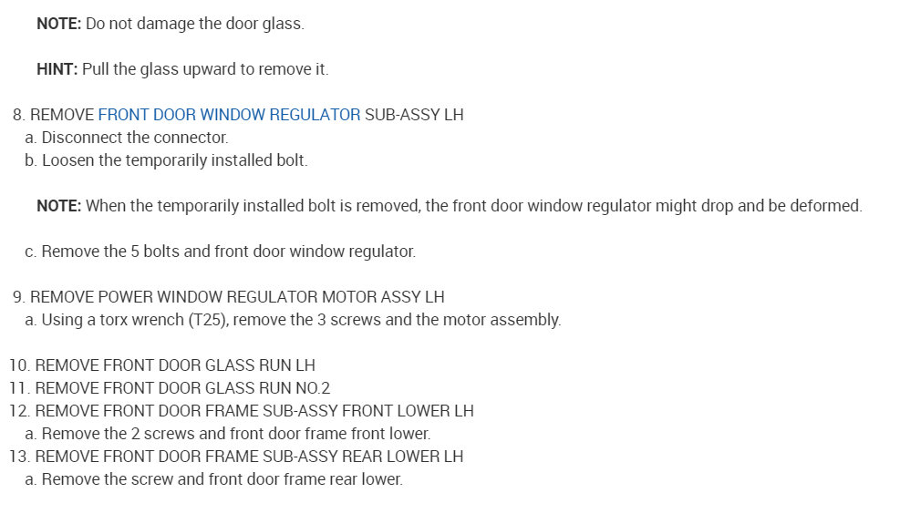

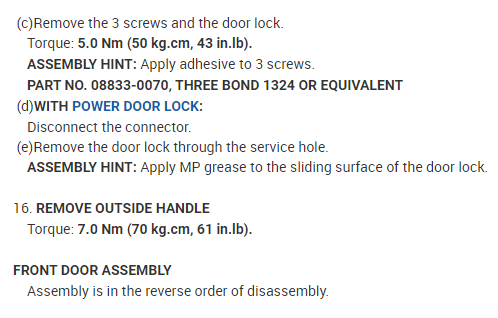

It sounds like you are having an issue with the window regulator. You will have to remove the door panel to gain access. Here are tutorials to get you started to remove the door panel and the window regulator:
https://www.2carpros.com/articles/door-panel-removal

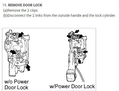

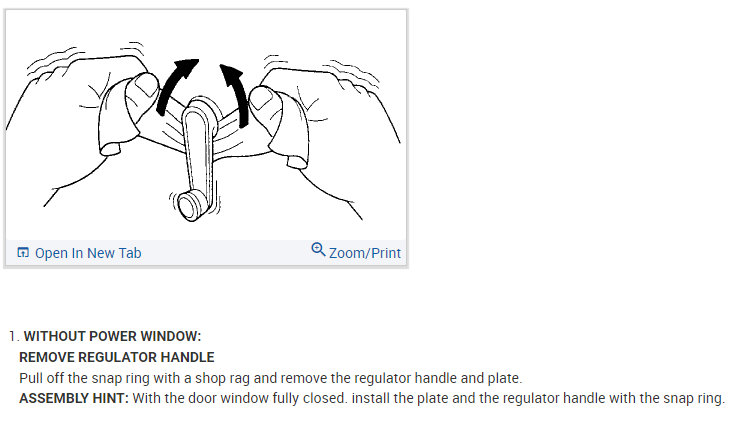

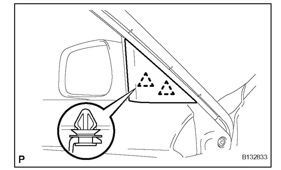

I've attached picture steps below on how to replace the power window regulator on your car. Hope this helps and thanks for using 2CarPros.

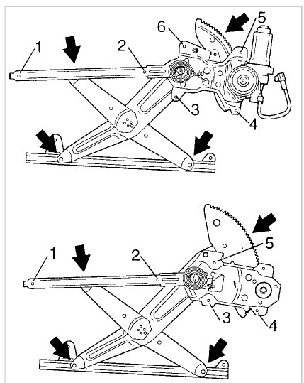

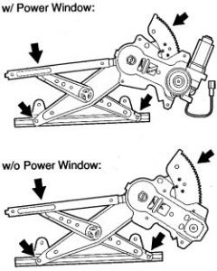

LB96FWV
My passenger window (power) fell down while driving down the road. I took the panel off and found that a piece was broken. I don't know what the part is called in order to ask for one at the auto parts store. Can you help me with a detailed diagram of parts that make up the window assembly?
KHLOW2008
  • 41,814 POSTS
Hi lb96fwv, The diagram shows a window regulator and if any part of it is faulty, the complete assy has to be replaced.
https://images.2carpros.com/forum/automotive_pictures/192750_WindowRegulator93CAmry_1.jpg
