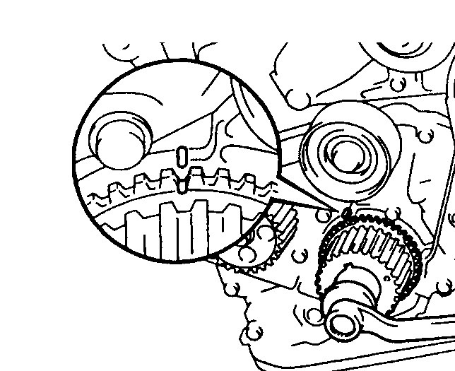

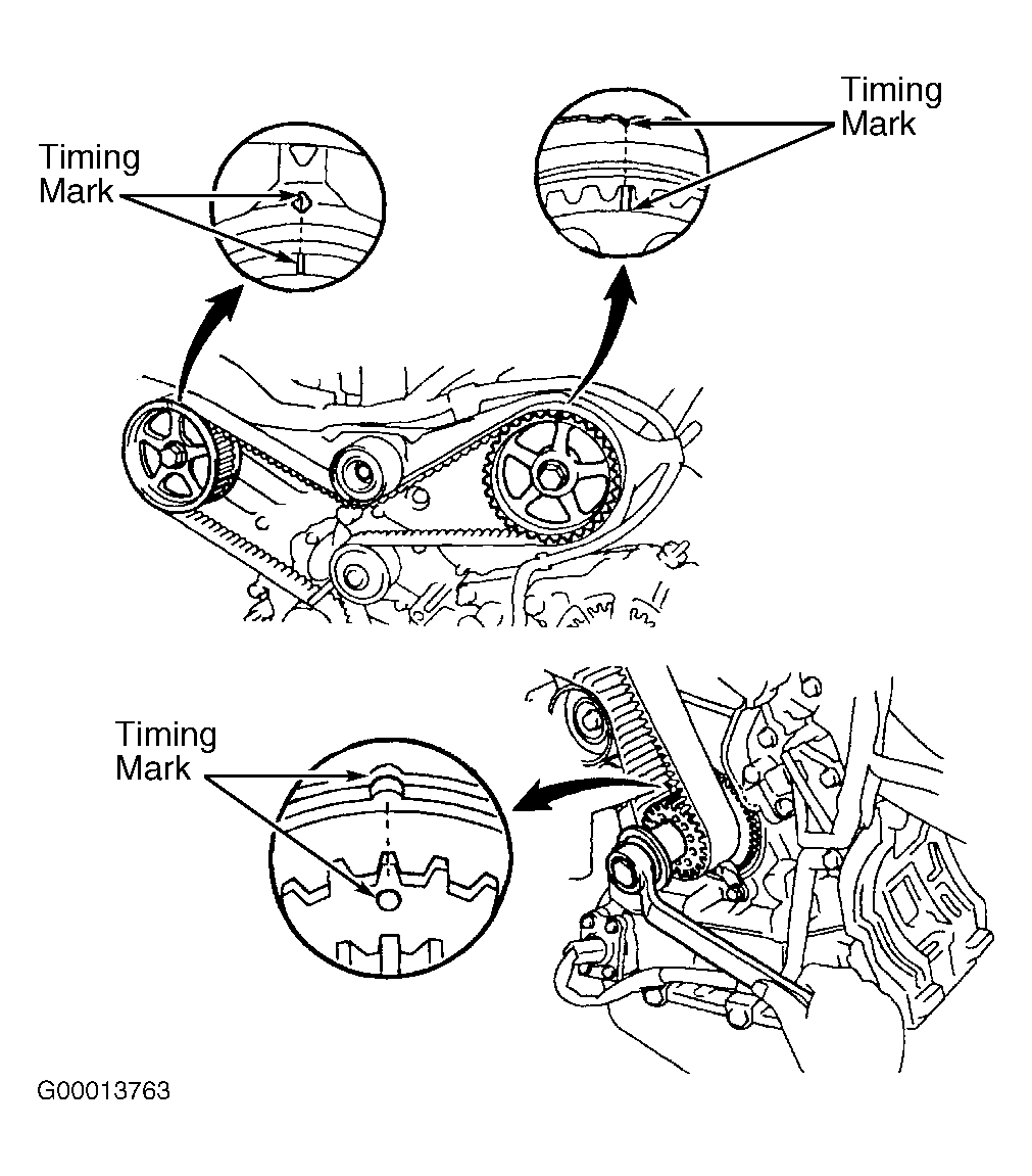

the ex-out cam has 3 marks (in, ex and the dot marking between the two) questing is which one do i use to put the timing correct?
May 10, 2010 at 5:21 AM
BLUELIGHTNIN6
  • 16,542 POSTS
Here are the timing belt diagrams to fit your car
https://www.2carpros.com/diagrams/toyota/camry/2005
May 10, 2010 at 5:25 AM

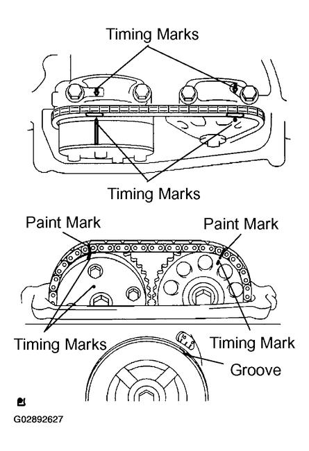

What are the timing marks for the car listed above 3.3L engine, V6?
Jul 27, 2020 at 5:36 AM (Merged)
  • 75,992 POSTS
Here is a guide and the diagrams below so you can see how the job is done:
https://www.2carpros.com/diagrams/toyota/camry/2004
Cheers

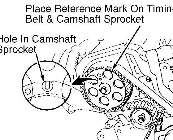

Hi guys Iam desperately in need of some detailed info on the camshafts timing marks, on the exhaust cam there are three marks one has two dots the others are ex. and in. and I cannot find a reliable source as to which of these marks should line up with the camshafts journal arrow please if u could provide some clear instructions thanks a lot
MHPAUTOS
  • 31,937 POSTS
See picture for timing marks.

Thanks for replying but still not clear on the pictures it does not show
which one of the three marks to use?

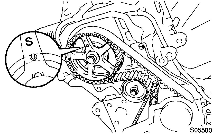

MELCARR0921
I need the timing marks for the car listed above. Please
Jul 27, 2020 at 5:37 AM (Merged)
BMDOUBLE
  • 1,139 POSTS
Here you go! Let us know if you need anything else.

CRYSTALN1
How do I determine the camshaft timing marks my engine? I am trying to figure out what the timing marks are, I have been unable to find anything online.
HMAC300
  • 48,601 POSTS
Check the images below
Installation
1. Install No. 2 idler pulley (if removed). Install and tighten bolt to specification. See TORQUE SPECIFICATIONS. Ensure idler pulley is clean and rotates smoothly.
2. Install No. 1 idler pulley and tension spring (if removed). Pry No. 1 idler pulley away from timing belt area as far as possible. Temporarily tighten No. 1 idler pulley bolt. Ensure idler pulley is clean and rotates
smoothly.

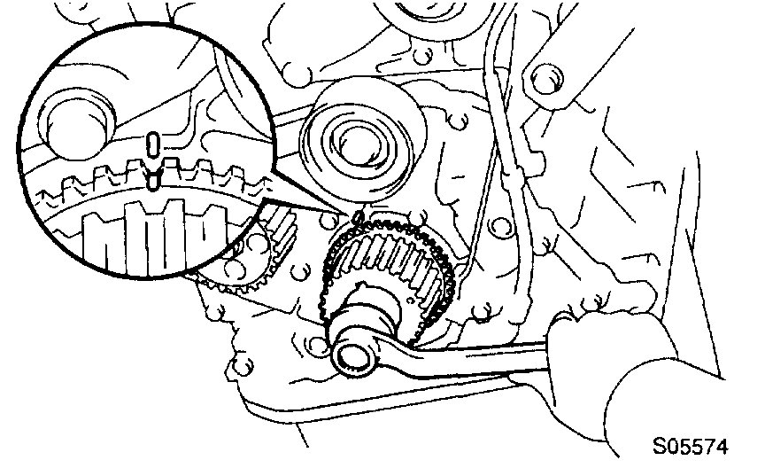

3. Using crankshaft pulley bolt, rotate crankshaft so timing mark on crankshaft sprocket aligns with timing mark on oil pump housing. See Fig. 4. This will position keyway in crankshaft sprocket at 12 o'clock
position.

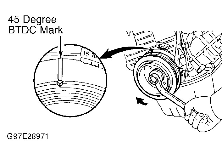

7. Rotate crankshaft clockwise so cylinder No. 1 is at TDC on compression stroke. Ensure timing mark on crankshaft pulley aligns with "0" mark on No. 1 timing belt cover. If reusing timing belt, ensure reference
mark on timing belt aligns with upper edge of No. 1 timing belt cover.
8. Rotate camshaft, and align hole in camshaft sprocket with alignment mark on camshaft bearing cap. See Fig. 2. Install timing belt on camshaft sprocket. If reusing timing belt, ensure reference mark on timing belt
aligns with the reference mark on camshaft sprocket. Ensure tension exists on timing belt between the crankshaft and camshaft sprockets.
CAUTION: DO NOT rotate crankshaft counterclockwise, as viewed from timing belt end of engine.
9. Loosen No. 1 idler pulley bolt 1/2 turn. Rotate crankshaft pulley 2 full revolutions clockwise from TDC to TDC.
10. Ensure timing mark on crankshaft pulley aligns with "0" mark on No. 1 timing belt cover, and hole in camshaft sprocket aligns with alignment mark on camshaft bearing cap. See Fig. 2. If timing marks are not
aligned, remove timing belt and reinstall.
11. Rotate crankshaft clockwise 1 and 7/8 revolutions and align crankshaft pulley "0" mark with 45 degree Before Top Dead Center (BTDC) mark on No. 1 timing belt cover. See Fig. 5.
12. Tighten No. 1 idler pulley bolt to specification. See TORQUE SPECIFICATIONS. Install No. 2 timing belt cover and gaskets. Install and tighten spark plugs to specification.

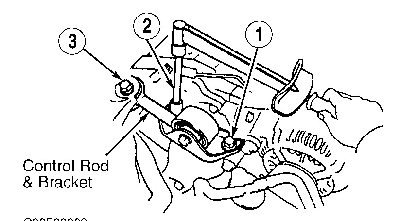

13. To install remaining components, reverse removal procedure. Install all bolts/nuts on right (timing belt side) engine mount before tightening to specification.
14. On Camry, when installing control rod and bracket on strut tower and right (timing belt side engine mount, tighten bolts to specification in sequence. See Fig. 6. On MR2, tighten engine mount bolts in correct
locations. See Fig. 7. Adjust drive belts to proper tension.
