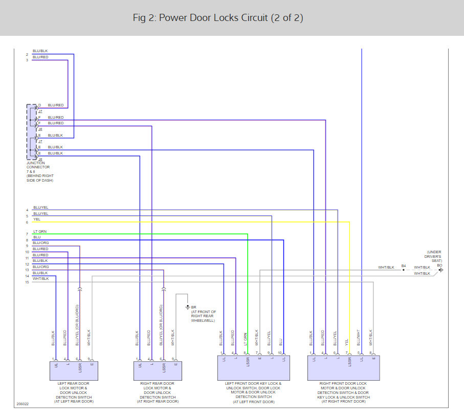

Electrical problem - 4 cyl Two Wheel Drive Automatic 62000 miles
Of our two 2005 Camry's, the auto door locks quit on all four doors on one car after a wreck and repairs were made. On the other Camry, the rear door locks quit unlocking going into gear and unlocking in park. Could this be just a programming issue with the cars. Two identical cars auto door locks stopped after 50,000 miles. A coincidence or known problem? If this is a program issue can you explain how we can reprogram ourselves?

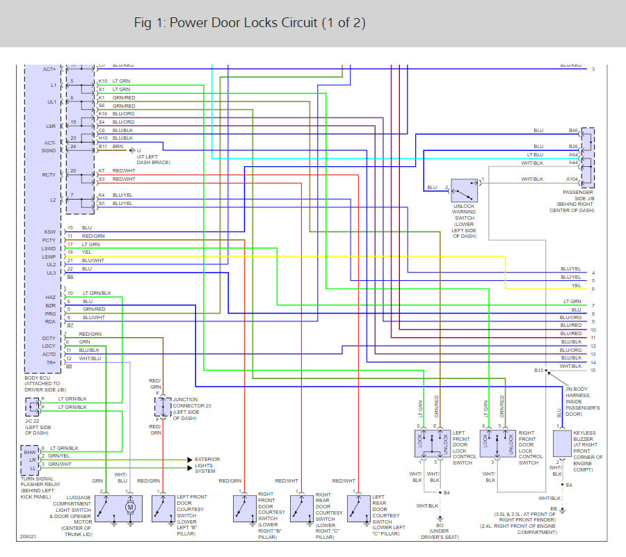

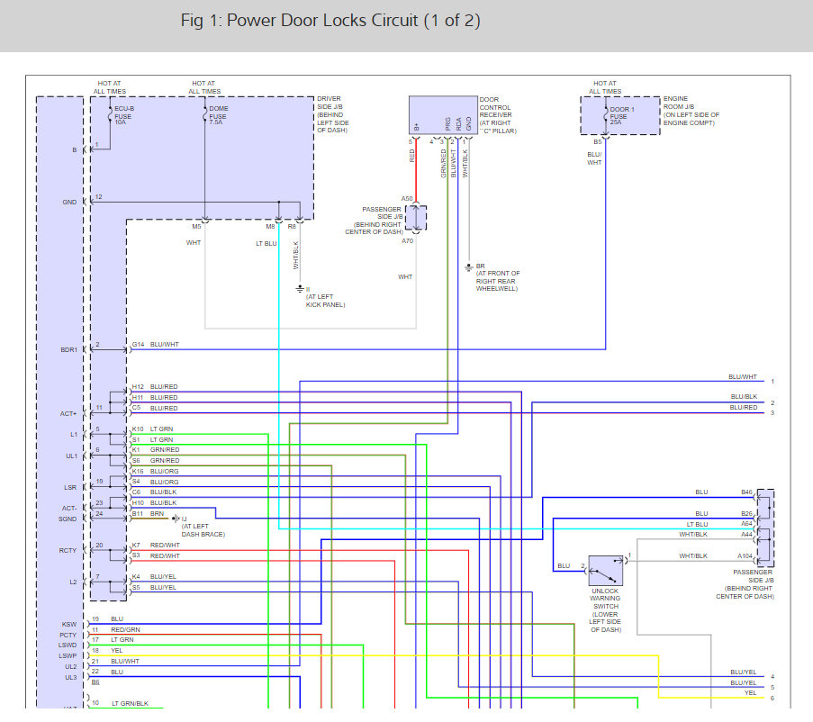

That can be the problem but let's look at the fuses and here are the door lock wiring diagrams to help you see how the system works (below).
