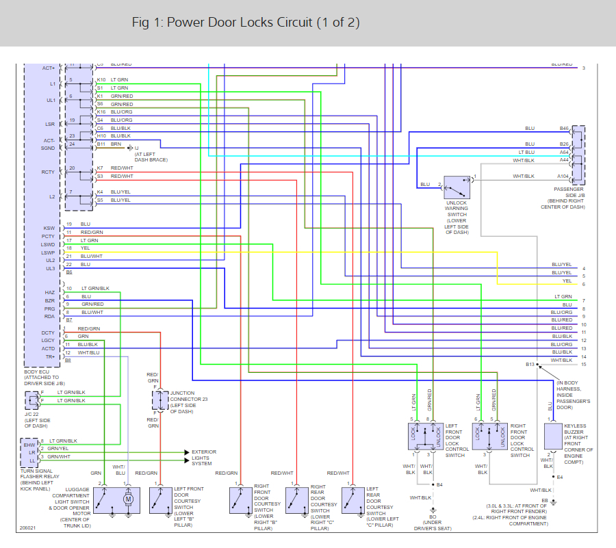

Electrical problem - 4 cyl Two Wheel Drive Automatic 62000 miles
Of our two 2005 Camry's, the auto door locks quit on all four doors on one car after a wreck and repairs were made. On the other Camry, the rear door locks quit unlocking going into gear and unlocking in park. Could this be just a programming issue with the cars. Two identical cars auto door locks stopped after 50,000 miles. A coincidence or known problem? If this is a program issue can you explain how we can reprogram ourselves?
Jul 19, 2010 at 1:42 PM
CJTOD

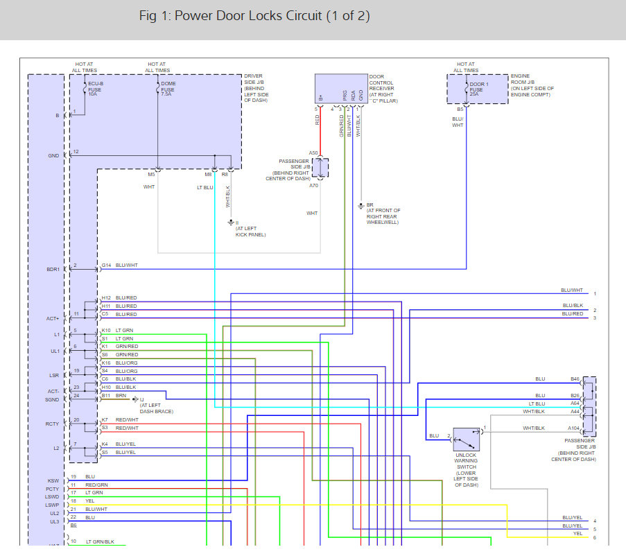

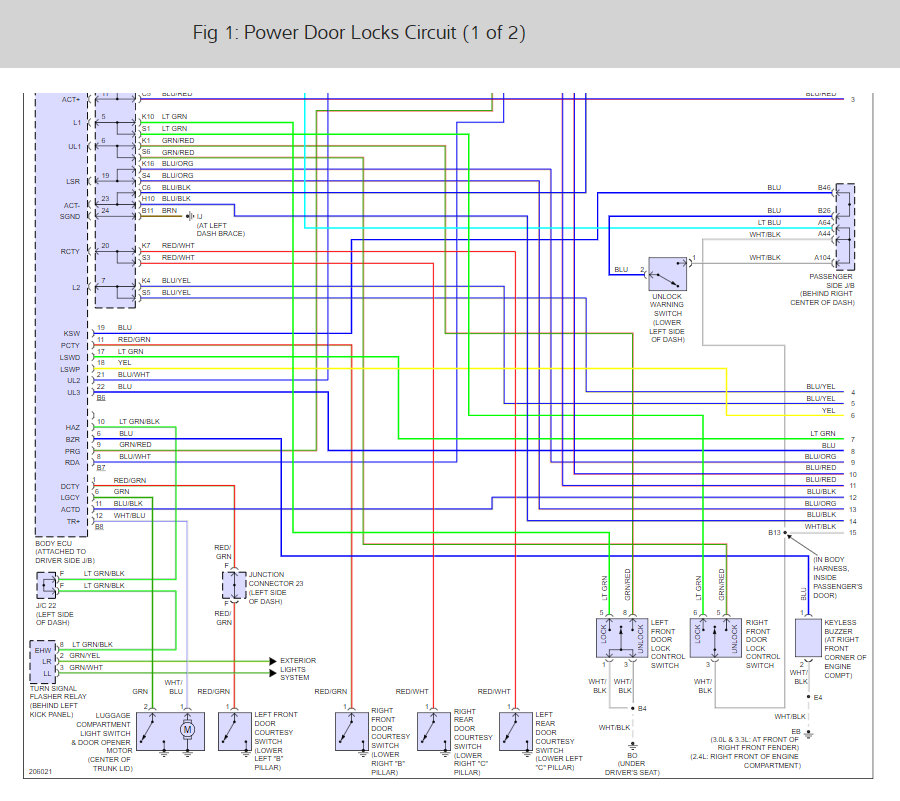

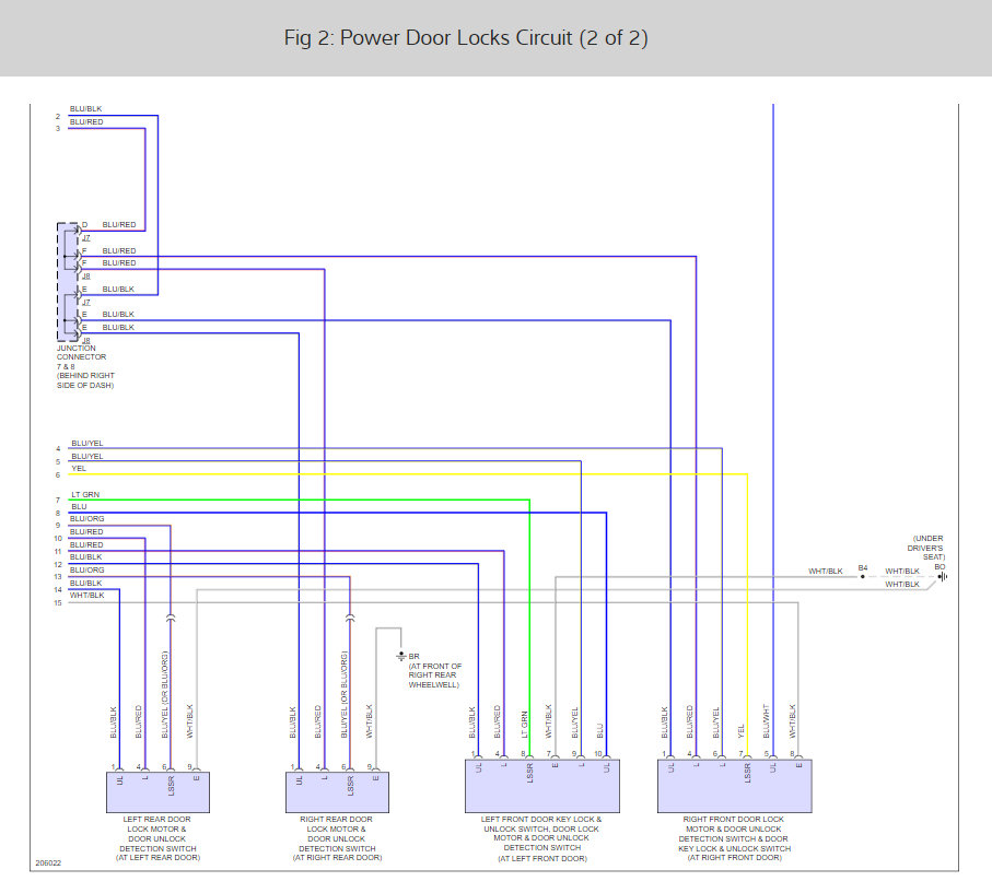

That can be the problem but let's look at the fuses and here are the door lock wiring diagrams to help you see how the system works (below).
Door Lock programming:
When the battery is disconnected, the ADL mode returns to the default setting (Mode A). The following procedure must be used to set the ADL function to Mode B whenever the battery has been disconnected.
Initialization Procedure
Perform the following procedure to initialize the ADL function to Mode B.
1. Move the shift lever into the "P" position and close all doors. 2. Turn the ignition switch to the "ON" position. 3. Within 10 seconds after the ignition switch is turned to the "ON" position, push and hold the rear side (unlock position) of the door lock switch for 5 seconds. 4. All doors will automatically lock and unlock when you release the power door lock switch. ^
This indicates that the ADL function is set to Mode B. If all doors do not lock and unlock, the time the switch was held may have been too short or too long. Perform the procedure over again starting from step 1.
If this doesn't work do a head system reset by removing the negative battery cable and holding it to the positive cable for 5 minutes this will discharge the capacitors and reset the system
Please check the fuses
