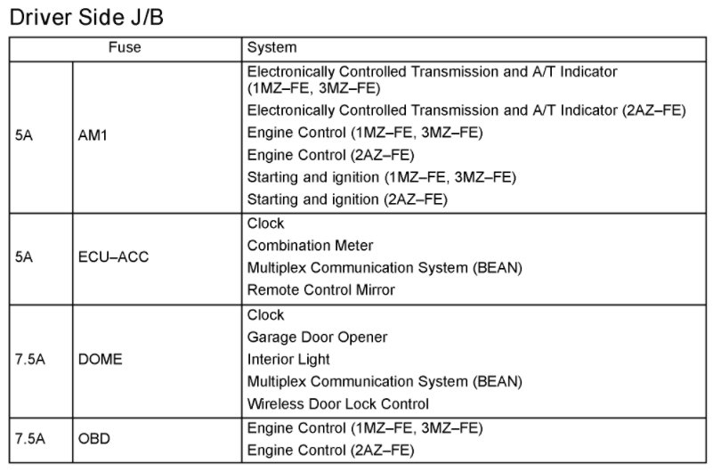

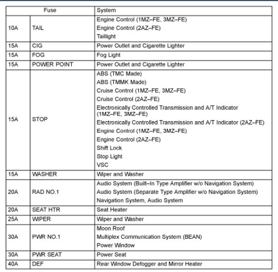

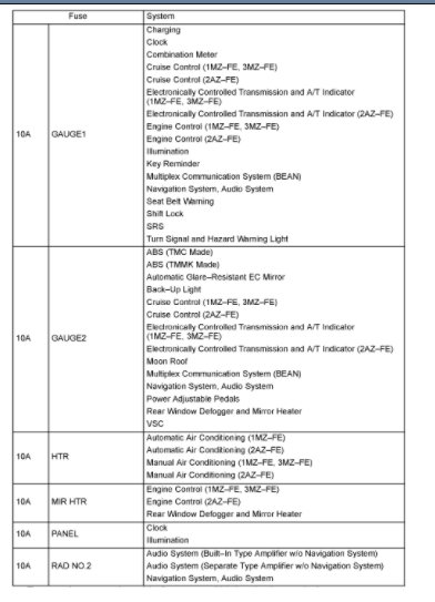

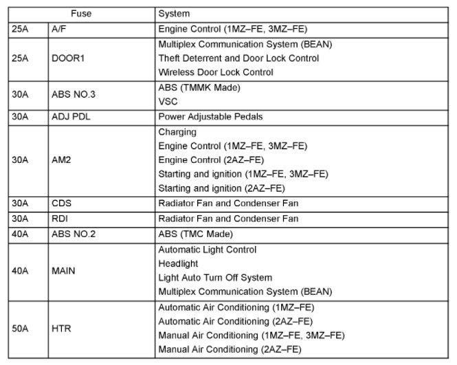

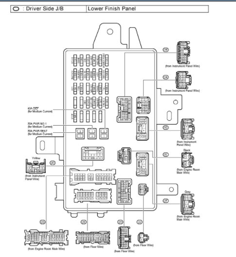

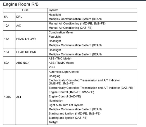

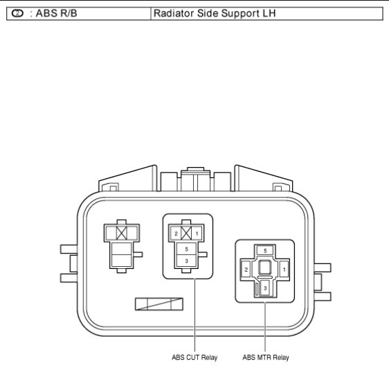

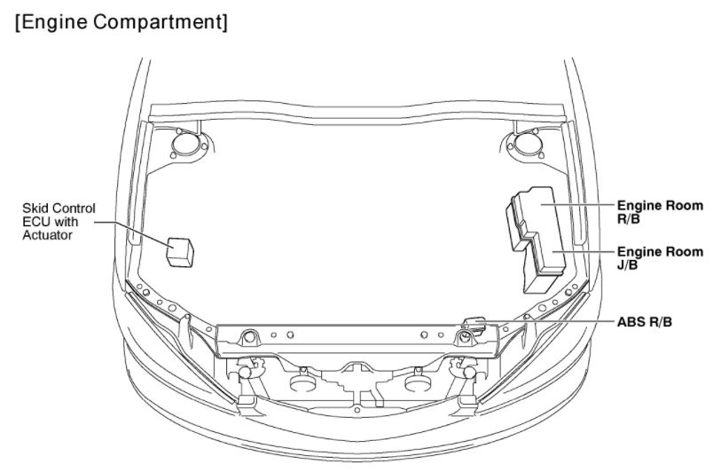

My wife insists that we check all the fuses in the car but I cant find them can you tell me how to check them as well? My oil change light wont go out.
Aug 24, 2008 at 7:47 AM
DANNY L
  • 5,648 POSTS
Hello, I'm Danny.

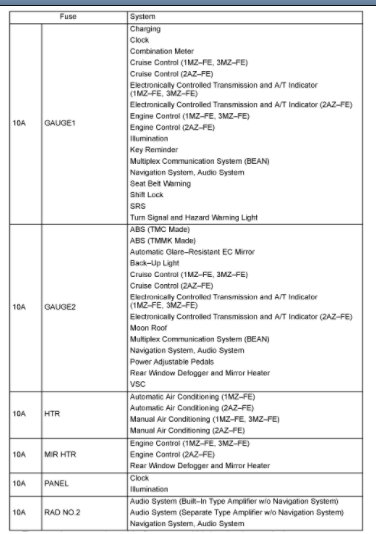

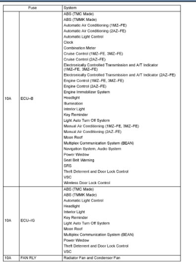

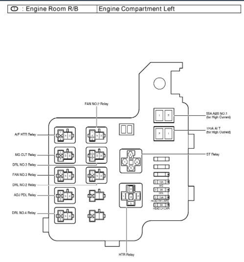

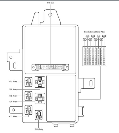

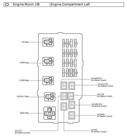

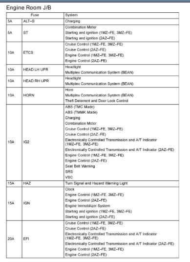

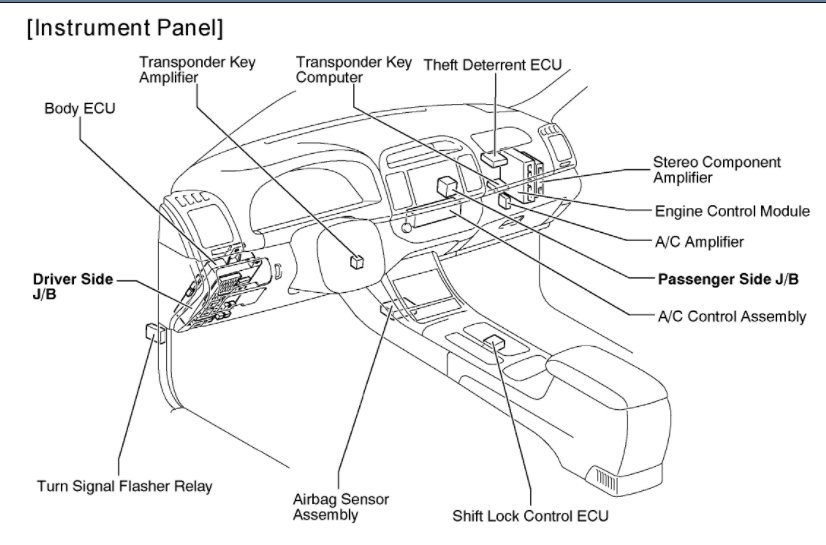

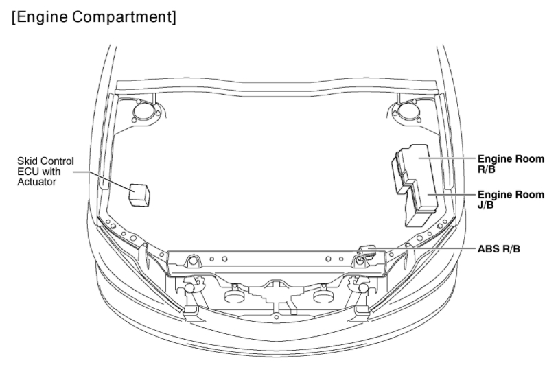

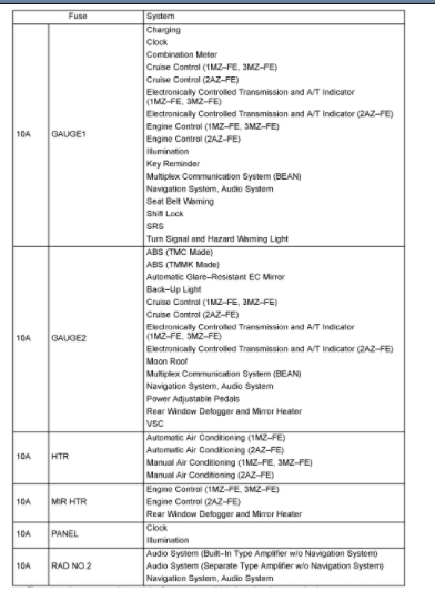

Here is the information you requested. Here are a few tutorials for you to view on how to check and replace fuses:
I've attached pictures below showing the fuse and relay locations on your car. Hope this helps and thanks for using 2CarPros.
