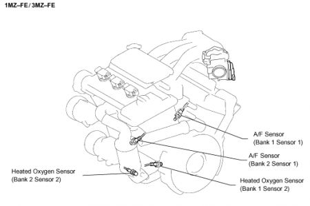

VSC, TRAC and Engine light is on when driving. OBDC shows P0031. Replace air fuel sensor with oem part 89467-06050 (after confirm that original part on veh is also 89467-06050/Denzo). Clear error codes with OBDC. VSC, TRAC, Eng lights came back on after short drive. After 2 days, tried reset by holding odometer button and turn on ignition and also clear error P0031, dash lights turned off successfully for about 20 minutes driving, but unfortunately turned on again. 5 days later, still hv same dash lights on and OBDC shows three monitor test not complete with icons flashing and gives error code P0031 twice. (only single P0031 before relacement air-fuel sensor). Replace the other air-fuel sensor located at bottom?? Thanks for help.

Which A/F sensor did you replace? The code says it is for Bank 1 Sensor 1. That would on the back of the motor on the exhaust manifold.
https://images.2carpros.com/forum/automotive_pictures/170495_o2_sensor_1.jpg
Jul 17, 2009 at 12:26 PM
S LAM
OMG, I replaced Bank 2 when I should have replace Bank 1. I presume Bank 1 would be the one on the front of the engine. I can kick my self. Where can I find diagrams like the one you are showing? Thank you.

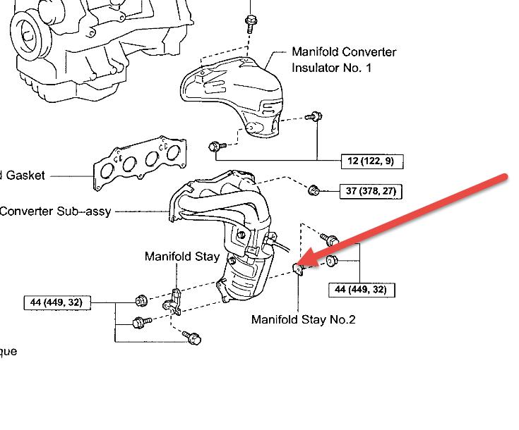

I forgot it's bank 1 sensor 1 that is the one in front of converter.
Sep 16, 2019 at 4:17 PM (Merged)
BENJAMINJOS
  • 13 POSTS
So it is in the main engine?. Where is the converter located?
HMAC300
  • CAR REPAIR CONTRIBUTOR
  • 48,601 POSTS
Here you go. Check out the diagrams (Below). Please let us know if you need anything else to get the problem fixed.
