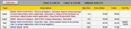

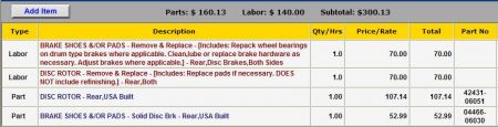

I have a camry-2004 SE and the mechanic suggested that the back breaks need changing. What will a rough estimate be like ? Also what would it be like if the rotors need working on. Thanks.

Is your vehicle equipped with rear drum brakes or rear disc brakes?

Its a 2004 Camry- SE model and not sure what brakes it has.

Okay, I will give you two seperate estimates then. First one will be for replacing rear brake pads and rotors. The other will be for replacing rear brake shoes and drums.
https://images.2carpros.com/forum/automotive_pictures/261618_Noname_796.jpg
https://images.2carpros.com/forum/automotive_pictures/261618_2_55.jpg
