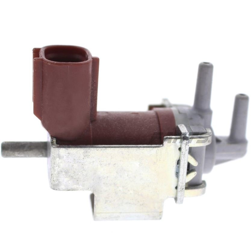

Hi, does anyone know where the purge valve is located for the vehicle stated above? Thank you! Also, I got a P0442 error code that said something along the lines of Evap emission leak. Is this the part that will correct the error? I looked at the other possibilities and they do not seem to be the issue.

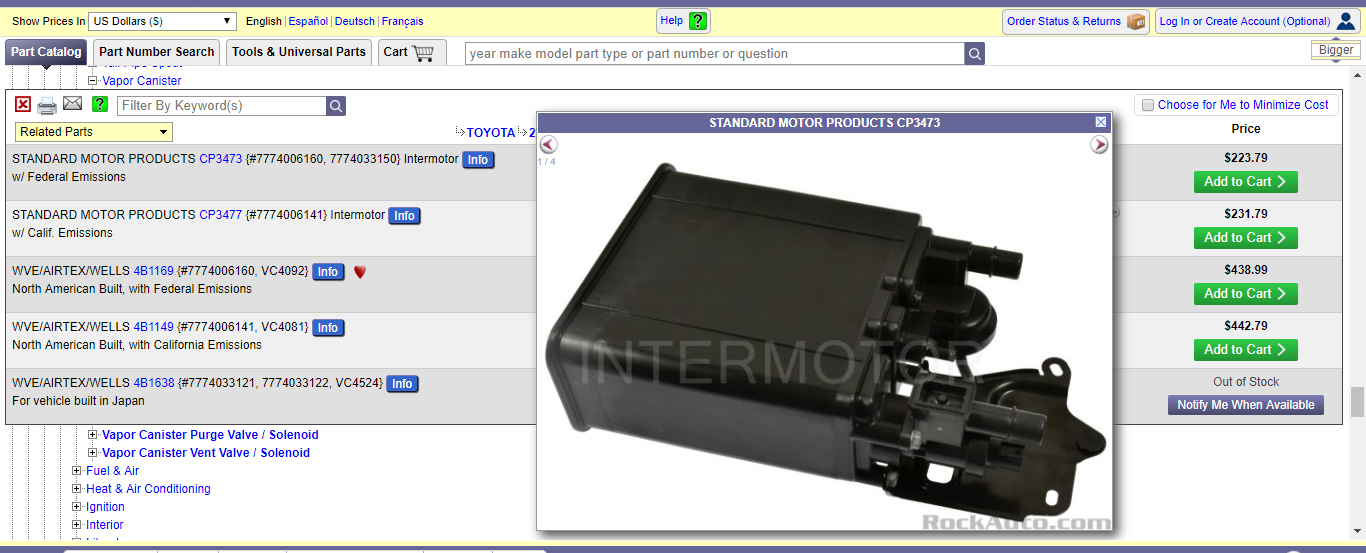

The purge valve is located on the canister at the rear of the car mounted on the cross frame.
It is common to replace the entire assembly for this as Toyota does not recommend replacing any components on the canister.
