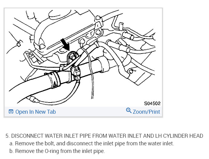

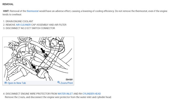

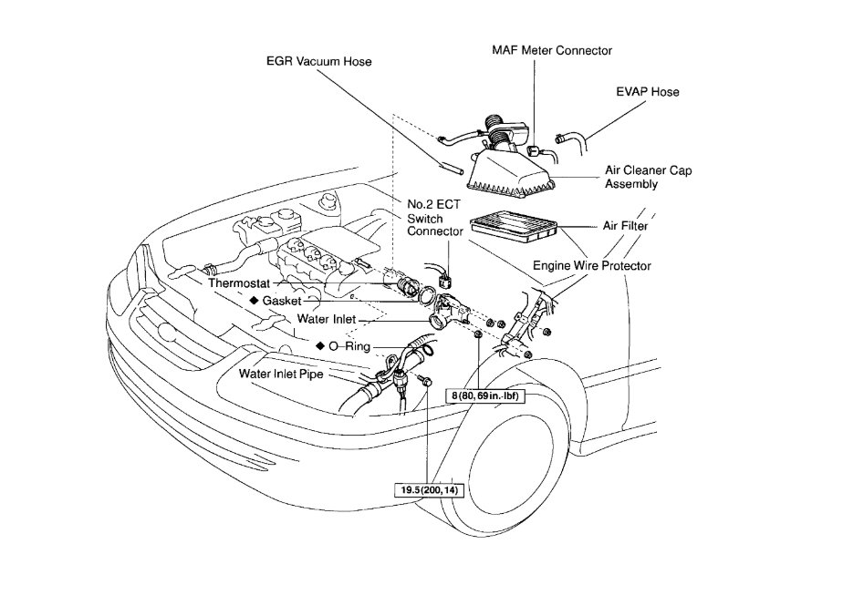

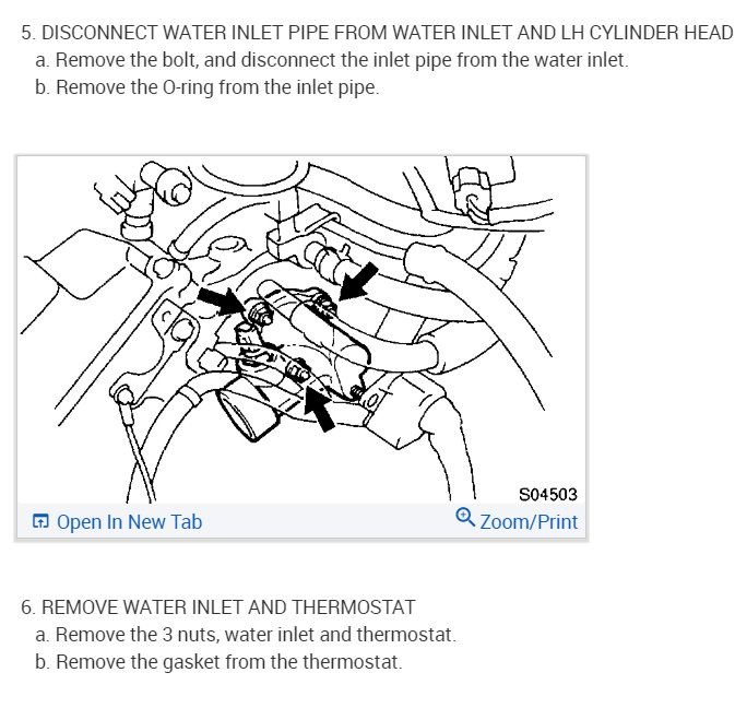

this just started this morning but i'm hesitant to drive it because i don't know if there is something more seriously wrong with it. no vibration, or engine shut off. i did notice that the heat output was not as warm as it normally is with the vents open so I need to replace the thermostat can you help me.
Nov 15, 2008 at 4:28 AM
ZACKMAN
  • 4,202 POSTS
Here is a guide to help you step by step with instructions in the diagrams below to show you how on your car.

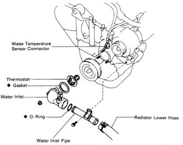

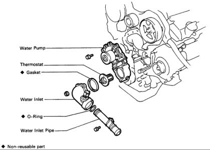

  • 75,988 POSTS

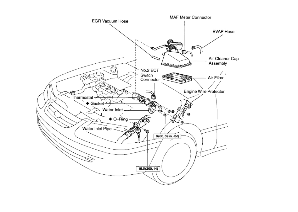

The thermostat is located near the front of the engine on the left side. Here is a video for the four cylinder and in the diagrams below it shows the 6 cylinder engine. Also this guide will help walk you through the steps.
and
https://youtu.be/drM2YOIJf4c

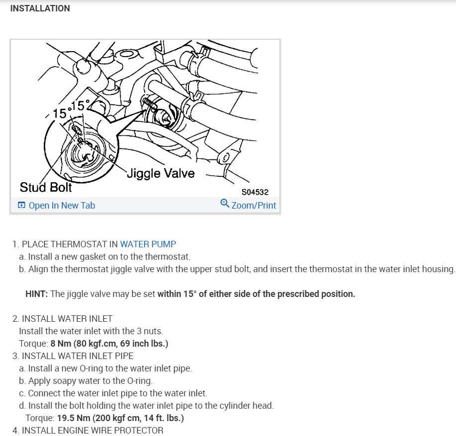

DSPLC
  • 220 POSTS
At the end of the lower hose, on the water pump underneath the alternator. When installing the thermostat, make sure the jiggle valve of the thermostat is facing upward where the arrow ^ of the inlet housing is pointing.

  • 75,988 POSTS
Follow the LOWER radiator hose to where it attaches to the engine. The hose is typically attached to an inlet pipe fitting behind which is a gasket and the thermostat. The gasket needs to be replaced when the thermostat is replaced.

  • 75,988 POSTS
Service and Repair
https://images.2carpros.com/forum/automotive_pictures/12900_t_28.jpg
On models with coded audio anti-theft systems, refer to Technician Safety Information for code procedures. Drain engine coolant. Remove water inlet pipe to alternator adjusting bar attaching bolts, then remove water inlet pipe and O-ring. Disconnect water temperature sensor electrical connector. Remove water inlet from water pump, then thermostat and gasket. Reverse procedure to install. Reset audio anti-theft system, if necessary, as outlined under Technician Safety Information. https://www.2carpros.com/kpages/auto_repair_manuals_alldata.htm

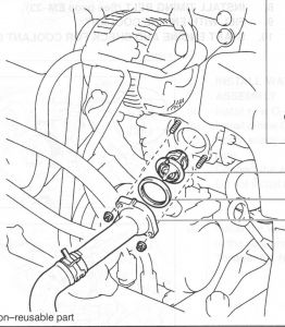

  • 75,988 POSTS
Follow the lower radiator hose it'll take you straight to it-
https://images.2carpros.com/forum/automotive_pictures/12900_thermostat_5.jpg

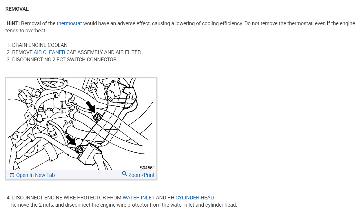

BLUELIGHTNIN6
  • 16,542 POSTS
Position a suitable drain pan under the radiator drain cock and drain the cooling system.
On the 1MZ-FE engine, remove the air cleaner cap assembly. Be sure to label all wiring disconnected.
Disconnect the water temperature switch harness from the water inlet housing (except 5S-FE engines).
Remove the oil filter on 5S-FE engines. On the 1MZ-FE engines, remove the heater hose covering the housing.
Loosen the hose clamp and disconnect the lower radiator hose from the water inlet housing.
Remove the two nuts from the water inlet housing and remove the housing from the water pump studs.
Remove the thermostat and rubber O-ring gasket from the water inlet housing.

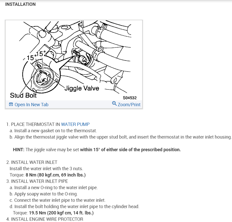

To install:
Make sure all the gasket surfaces are clean. Clean the inside of the inlet housing and the radiator hose connection with a rag.
Install the new rubber O-ring gasket onto the thermostat. On 2SE and 3S-FE engines, align the jiggle valve of the thermostat with the protrusion on the water inlet housing. On 5S-FE engines, align the jiggle valve with the upper side of the stud bolt. On 2VZ-FE and 3VZ-FE engines, align the jiggle valve with the stud bolt. Insert the thermostat into the housing.
Position the water inlet housing with the thermostat over the studs on the water pump and install the two nuts. Tighten the two nuts to 78 inch lbs. (9 Nm) on 4 cyl. engines, 2VZ-FE and 3VZ-FE; 14 ft. lbs. (20 Nm) and 69 inch lbs. (8 Nm) on 1MZ-FE engines.
Don't forget to install a new O-ring onto the water inlet pipe. Apply soapy water to the O-ring prior to installation.
Connect the lower radiator hose to the inlet housing and install the hose clamp. On the 3VZ-FE, tighten the bolt holding the water inlet hose to the alternator belt adjusting bar to 14 ft. lbs. (20 Nm). On the 1MZ-FE engine, tighten the bolt retaining the water inlet pipe to the cylinder head to 14 ft. lbs. (20 Nm).
Attach the water temperature switch connector.
On the 1MZ-FE engines, install the heater hose removed.
Install the oil filter and check the oil level if removed. Install the air cleaner cap assembly on the 1MZ-FE engines.
Fill the cooling system with a good brand of ethylene glycol based coolant.
Start the engine and inspect for leaks.

MHPAUTOS
  • 31,937 POSTS
The thermostat is under the domed housing that the bottom radiator hose connects to at the engine. It is secured with 2 10mm nuts. Make sure that the toggle valve is uppermost when replacing. also bleed system with heater tap open.
