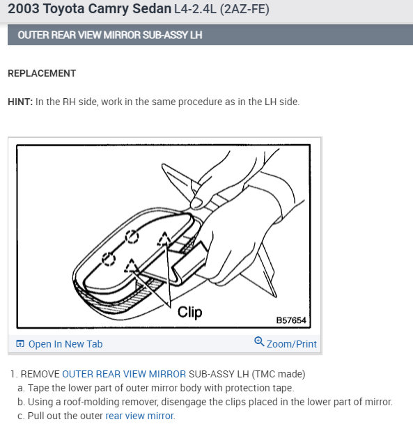

What is the replacement procedure for the driver side mirror. It is motorized but not heated.

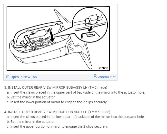

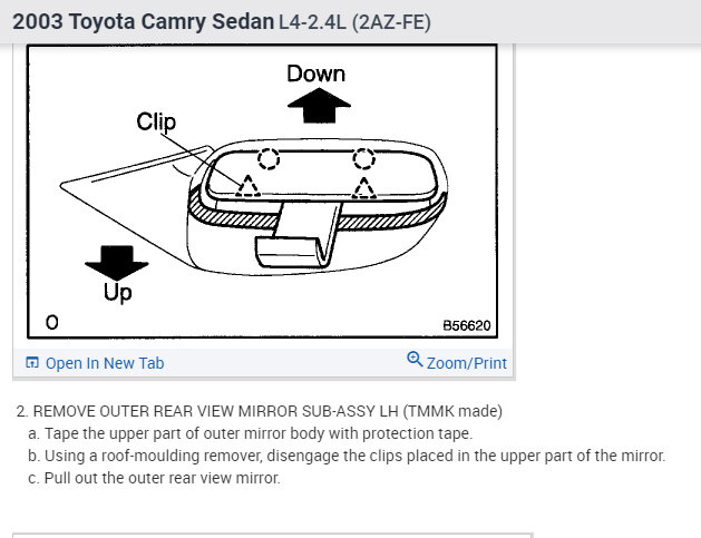

The outside mirror replacement procedure is very simple.
First you will have to remove the triangular shape plastic cover that is located inside the door at the back of the mirror mounting point. Removing that cover will give you access to the mounting bolt.
Simply unplug the wire and take off the nuts.
