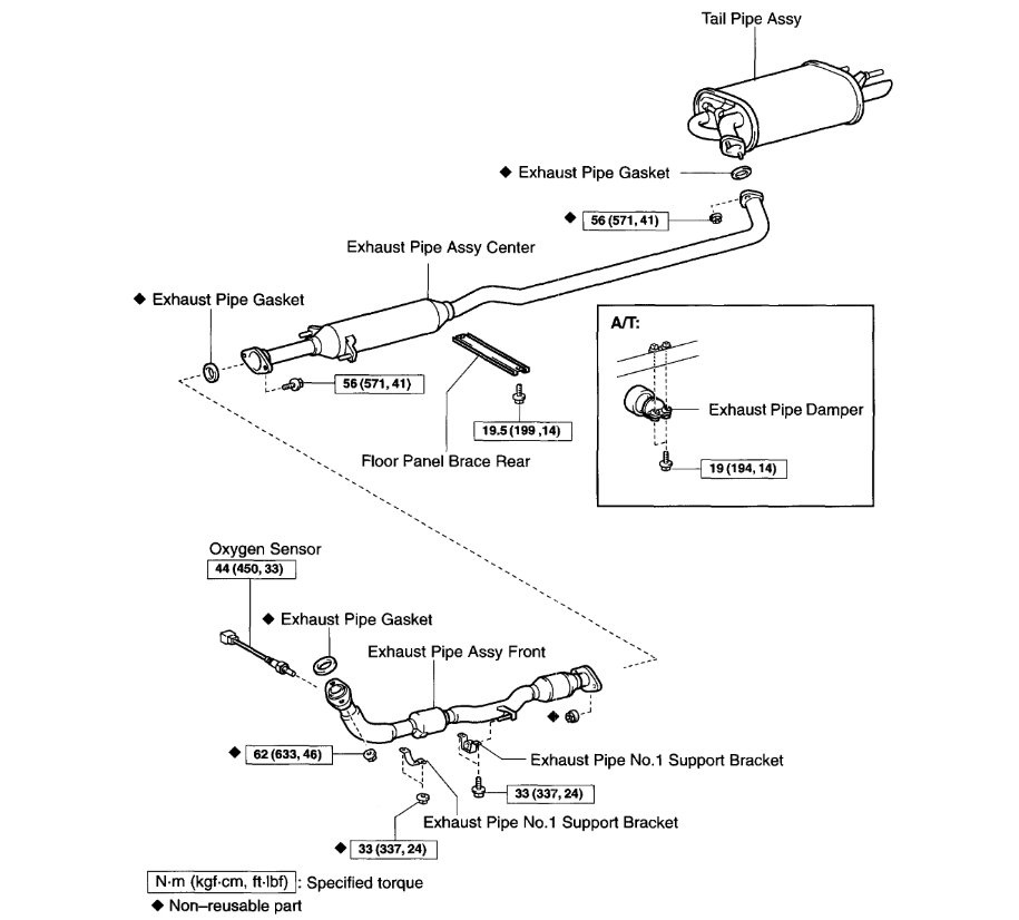

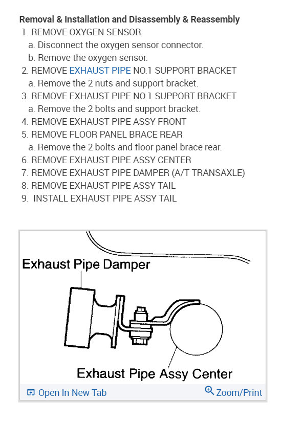

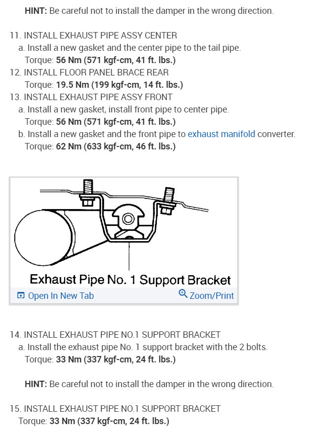

Catalytic Converter Replacement Instructions ?
2003 TOYOTA CAMRY
114,000 MILES • 4 CYL • FWD • AUTOMATIC
SMBANGER
I want to know how to my catalytic converter can you help me please?
Feb 21, 2010 at 12:58 PM
Here is a guide to help you step by step on how to replace the cat converter with instruction in the diagrams below to show you how on your car.
https://www.2carpros.com/articles/catalytic-converter-replacement
