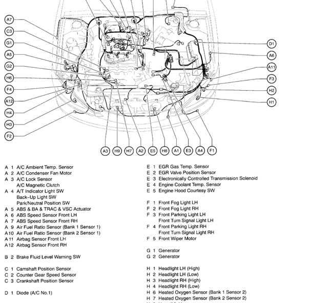

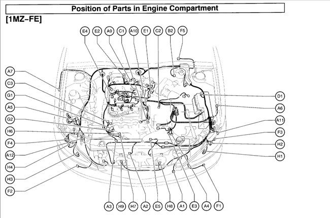

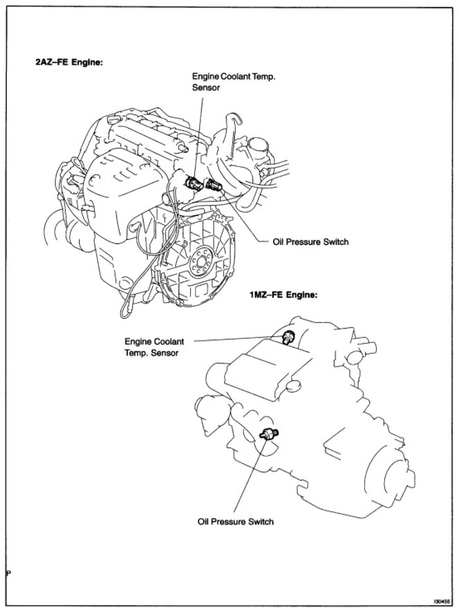

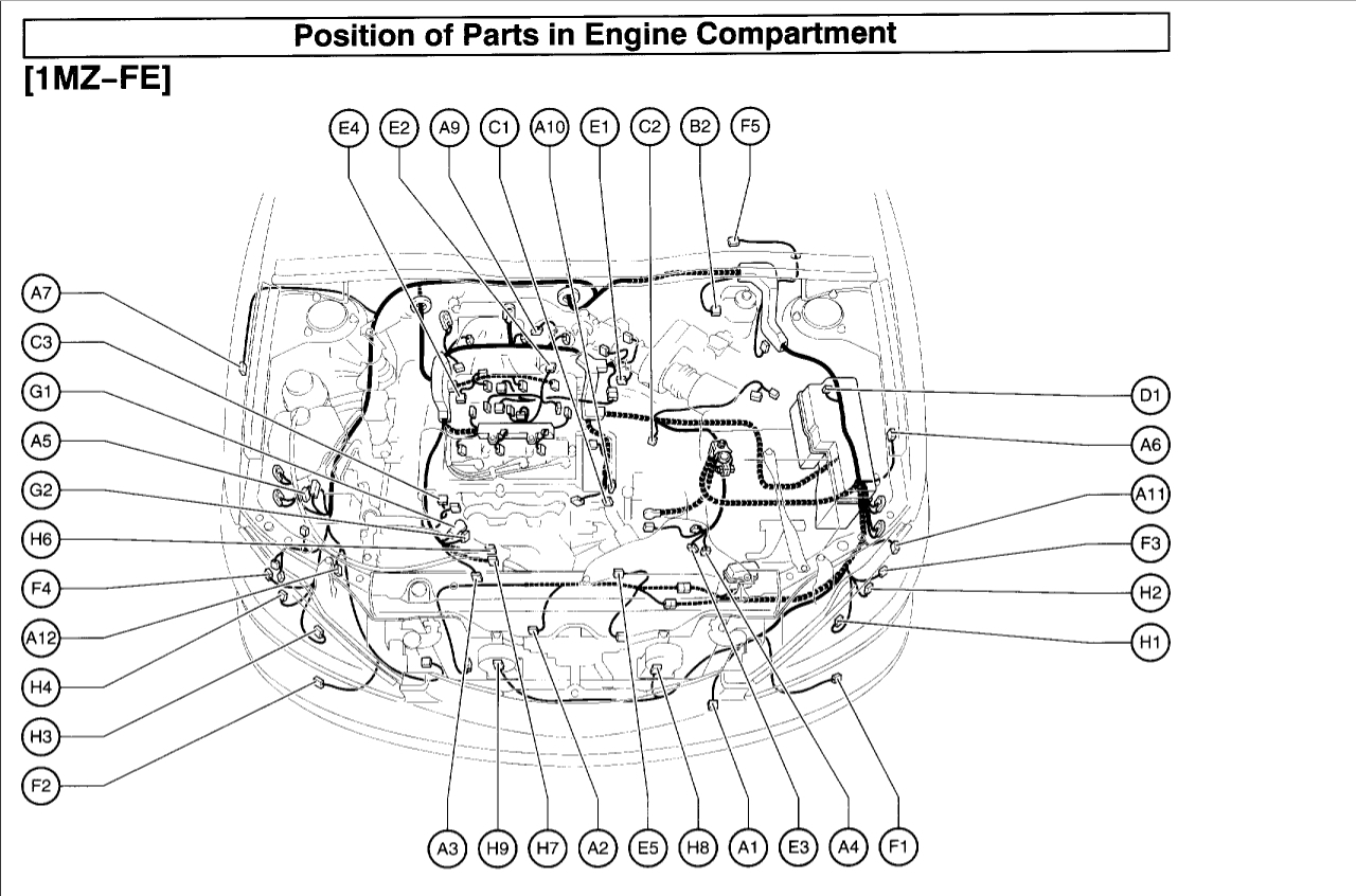

These cars had a common problem with the coolant temperature sensor going out. I would start by replacing it. Here is a guide to get your started.
https://www.2carpros.com/articles/coolant-temperature-sensor-cts-replacement
Here is where it is in your car (below) I have both engines.
Oct 10, 2017 at 7:50 AM

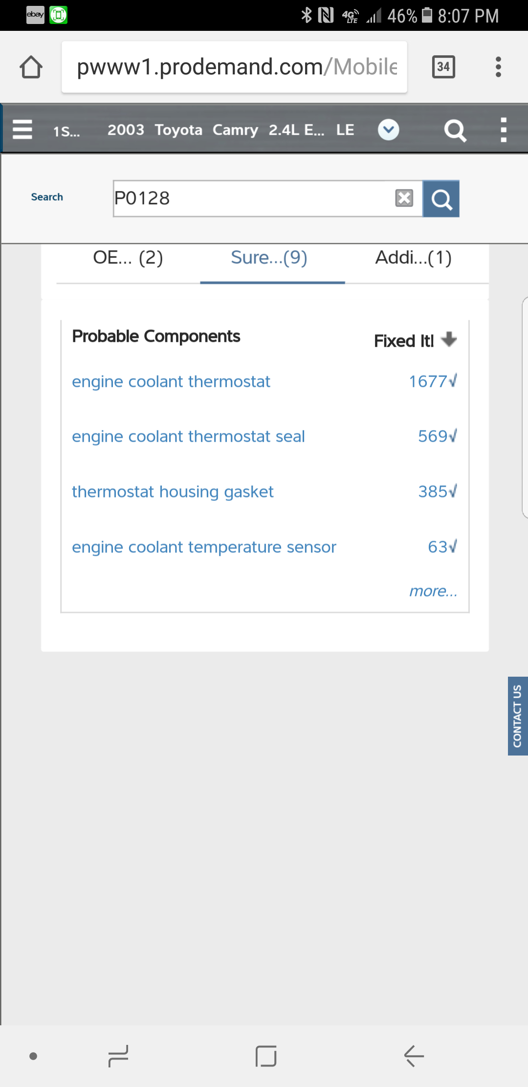

I would be replacing the thermostat for that code that's a universal code for many makes and models for a bad thermostat I have replace a thermostat for many makes and models for that code.
Oct 10, 2017 at 1:06 PM
SATURNTECH9
  • 30,869 POSTS
There's the stats for confirmed fixes to back up my thoughts on it's a bad thermostat.
