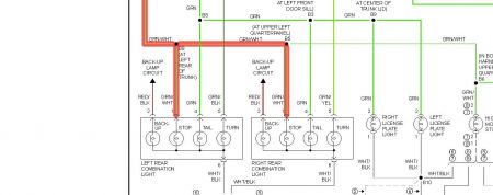

My rear passenger brake light won't come on. I've changed the bulbs and the fuse and still get nothing. What should I look to do next to fix this issue?

Hi dfuimaono, Welcome to 2carpros and TY for the donation Your problem here could be the bulb socket, the green and white is open at the splice point at left rear of trunk or between it and the bulb socket
https://images.2carpros.com/forum/automotive_pictures/12900_brake_14.jpg
