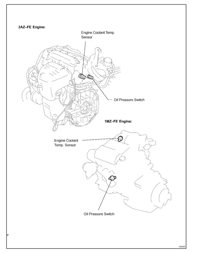

I have a friend that took her car in because of the Oil light and Service Engine light. The shop says that the SE light is coming on because the Oil light being on is throwing that code. Okay I can go with that. This is an intermittent problem, and the car is not ticking or knocking. The shop gave her an estimate cost of repairs at $2,500.00. It seems they are saying she needs a new oil pump. What she can't find out from them is whether or not they actually check the oil pressure. So I guess my question is, do Toyota Camry's have any history of oil pumps failing at only 166,000 miles or is it more likely a bad or clogged oil sending unit?

the oil pressure sensor is located at the rear of the engine up by the cylinder head. Check out the diagrams (below). Please let us know if you need anything else to get the problem fixed.
