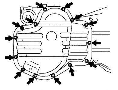

On this model will the oil pan drop down without any other parts being removed or the engine moved in any direction?

Hello I have attached the information on the oil pan removal. REMOVE OIL PAN DRAIN PLUG AND DRAIN OIL.
https://images.2carpros.com/forum/automotive_pictures/248015_Oil_1_1.jpg
REMOVE OIL PAN SUB-ASSY (a) Remove the 12 bolts and 2 nuts.
https://images.2carpros.com/forum/automotive_pictures/248015_oil_2_1.gif
Insert the blade of SST between the crankcase and oil pan. Cut off applied sealer and remove the oil pan. SST 09032-00100 NOTICE : Be careful not to damage the contact surface of the cylinder block and oil pan. INSTALL OIL PAN SUB-ASSY

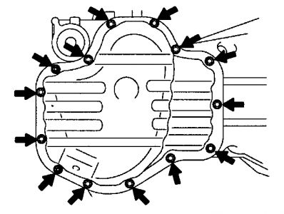

INSTALL OIL PAN SUB-ASSY NOTICE: Remove any oil from the contact surface. Install the oil pan within 3 minutes after applying seal packing. Do not start the engine for at least 2 hours after installing. (a) Remove any old packing (FIPG) material and be careful not to drop any oil on the contact surfaces of the cylinder block and oil pan. (b) Apply seal packing in a continuous bead (diameter: 3 mm to 4 mm (0.157 in.) as shown in the illustration, and install the oil pan. Seal packing: Part No.08826-00080 or equivalent
https://images.2carpros.com/forum/automotive_pictures/248015_oil_4_1.jpg
Install the oil pan with the 12 bolts and 2 nuts. Torque: 9.0 N.m (92 kgfcm, 80 in..lbf) INSTALL OIL PAN DRAIN PLUG Install a new gasket and oil pan drain plug with a new gasket. Torque: 25 N. (255 kgfcm, 18 ft.lbf)

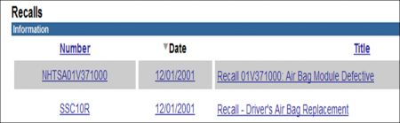

Oh I forgot to mention. Looks like you may have some recalls on your vehicle. The dealer may fix these for free. Please contact the dealer service department, give them the VIN number of your car and have them check on these to see if they apply to you.
