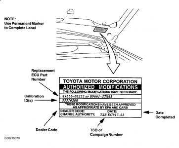

You did say the ECM was reflashed with the new software, and this label was applied under the hood on the driver's side? Toyota suggests test the fuel control circuit for "surging" problems.
ï¬ On Avalon, Camry 2.2L 4-cylinder gasoline models, Camry 3.0L V6, Camry Solara, Celica, Corolla, ECHO, Highlander, MR2, Prius, RAV4, Sienna, Tacoma, Tundra 3.4L V6 and 4Runner, check fuel pump control circuit. See FUEL PUMP CONTROL CIRCUIT under COMPUTERIZED ENGINE CONTROLS in appropriate SYSTEM & COMPONENT TESTING article.

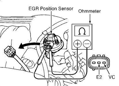

EGR Position Sensor (Camry & Camry Solara) 1. Disconnect electrical connector at EGR position sensor. EGR position sensor is located on top of EGR valve. See Fig. 172 . 2. Using ohmmeter, check resistance between terminals E2 and VC on EGR position sensor. See Fig. 172 . Resistance should be 1500-4300 ohms. If resistance is within specification, reinstall electrical connector on EGR position sensor and go to next step. If resistance is not within specification, replace EGR position sensor. See EGR POSITION SENSOR under ENGINE SENSORS & SWITCHES in REMOVAL, OVERHAUL & INSTALLATION - V6 & V8 article. 3. To test EGR position sensor output voltage, disconnect vacuum hose from EGR valve. Remove glove box for access to Engine Control Module (ECM). Turn ignition on. Using voltmeter, check voltage between ECM terminals E2 (Brown wire) and VC (Yellow wire). See Fig. 173 and Fig. 174 . Voltage should be 4.5-5.5 volts. Remove voltmeter. 4. Connect voltmeter between ECM terminals E2 (Brown wire) and EGLS (White/Green wire). See Fig. 175 and Fig. 176 . Using vacuum pump, apply 5.1 in. Hg of vacuum to EGR valve and note voltage. Voltage should be 3.2-5.1 volts with vacuum applied on EGR valve. Release vacuum from EGR valve and note voltage. Voltage should be .4-1.6 volts with vacuum released from EGR valve. Replace EGR position sensor if voltage is not within specification. See EGR POSITION SENSOR under ENGINE SENSORS & SWITCHES in REMOVAL, OVERHAUL & INSTALLATION - V6 & V8 article. Remove vacuum pump and reinstall vacuum hose on EGR valve. NOTE: EGR position sensor may also be referred to as EGR valve position sensor.
Also you can pull of the vacuum hose and use a vacuum pum with engine running, if it starts to stall or run rough with vacuum applied, release the vacuum, if it smoothes out, the EGR isnt sticking...this has an electronic position sensor mounted on top of it, if it's open at the wrong time, a code will set and turn on the check engine light.
