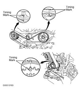

2002 Toyota Camry 6 cyl Front Wheel Drive Automatic
I replaced the timing belt & waterpump didnot disconnect any vacuum lines the car runs great on the road however it willnot idle . There are no codes ,i triedIholding throttle at 2500 for 90 seconds, it didnot help. I tripled checked my marks.Please tell me what you think
Aug 3, 2008 at 9:44 AM
KHLOW2008
  • 41,812 POSTS
Hi winfred1, I still think it is the timing belt markings.
https://images.2carpros.com/forum/automotive_pictures/192750_Camry02Timingbelt_1.jpg
You need to check for loose wire connectors or grounds.
