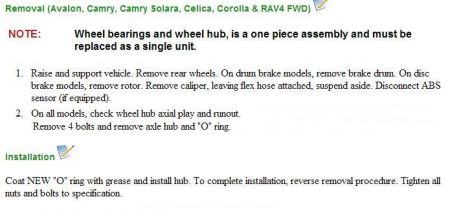

2001 Toyota Camry right back wheel bearing
14,500 MILES • 4 CYL • FWD • AUTOMATIC
DONRIT10
how do i replace the right back wheel bearing

BLUELIGHTNIN6
  • 16,542 POSTS
https://images.2carpros.com/forum/automotive_pictures/261618_Noname_810.jpg
