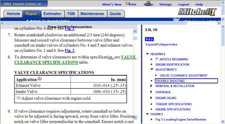

Can you adjust the lifters on a 2001 camry?
Oct 20, 2008 at 6:22 PM
  • 75,992 POSTS
Try adjusting it-see below
https://images.2carpros.com/forum/automotive_pictures/12900_valve_clearance_adjust_1.jpg
