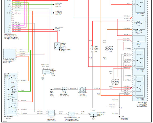

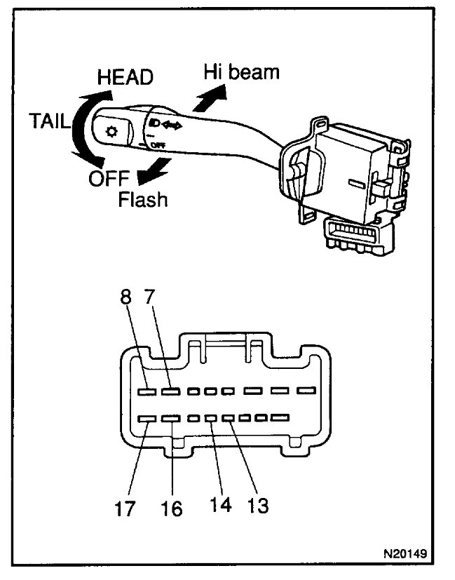

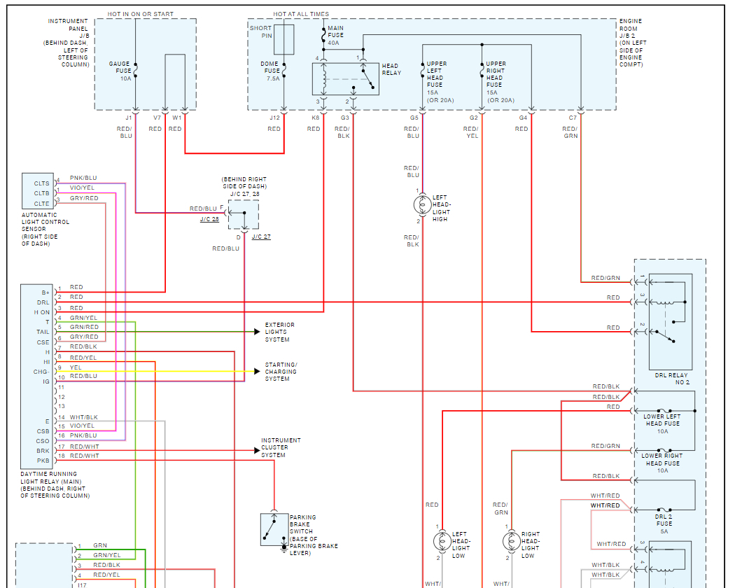

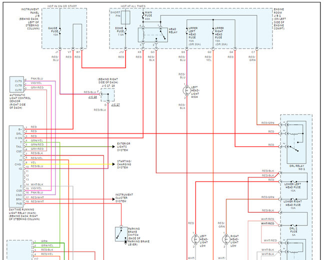

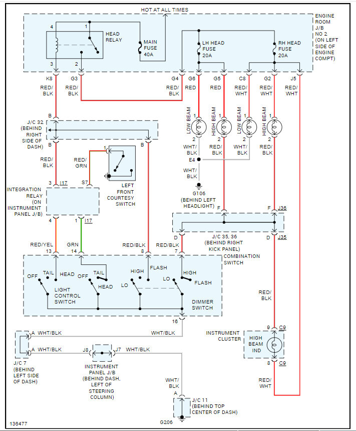

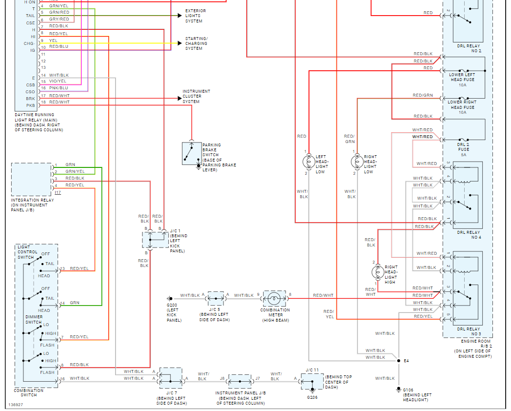

High beam does not work on my 01 camry. Where is the headlight relay and wire harness located? Fuses are ok and dimmer switch has continuity
Dec 26, 2008 at 8:49 PM
MHPAUTOS
  • 31,937 POSTS
Hi there,
The headlight switch is probably the problem, if it was a ground or the power supply the other low beam lights would not work, here is how to change the headlight switch out to fix the problem. Also I have included the headlight wiring diagrams so you can see how the system works.
