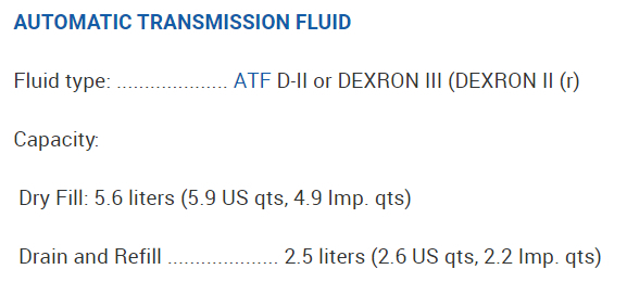

Transmission fluid type?
2001 TOYOTA CAMRY
75,000 MILES • 4 CYL • FWD • AUTOMATIC
BNH
Should I use the expensive fluid from the dealer or just use Dexdron III as written on the dipstick?
Feb 7, 2008 at 11:41 PM
DANNY L
  • CAR REPAIR CONTRIBUTOR
  • 5,648 POSTS
Hello, I'm Danny.

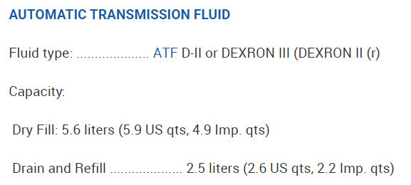

If you want to save some money Dexron III works just as good as the dealer brand. I've attached a picture below of the automatic transmission requirements and specifications. Hope this helps and thanks for using 2CarPros.
