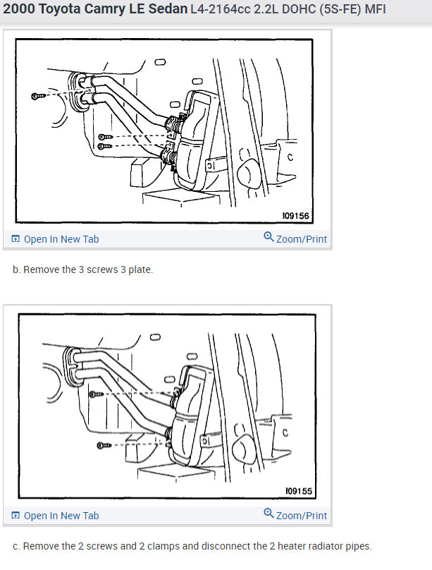

My drivers side (front & back) floor boards are soaking wet! There is a slow drip that I can feel on my foot when it is on the gas pedal. ???could it be the heater core?
May 23, 2008 at 5:48 PM
SQM
  • 6,383 POSTS
Are you getting water or coolant leaks in side the vehicle?
Coolant will have a sweet smell.

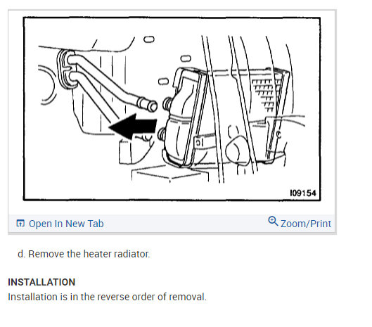

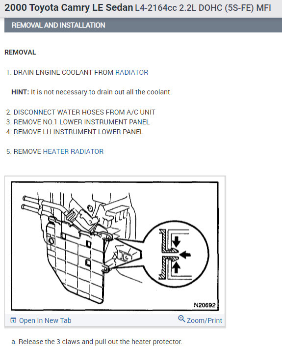

If it is coolant then it is likely a leaky heater core or loose hose.
https://www.2carpros.com/articles/replace-heater-core
You can also have water condensation leaking from the AC evaporator.
There is a drain tube for the evaporator that drains the water to the outside.
But dirt and debris can clog that drain hose and that can make the water leak inside the car.
