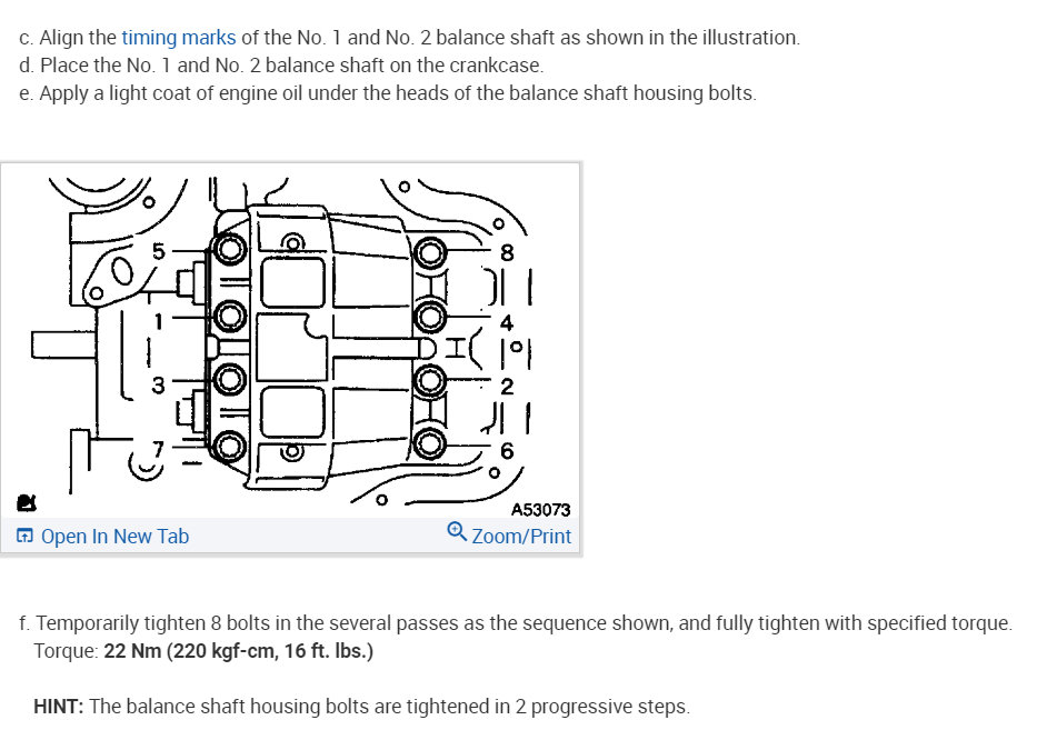

MHPAUTOS
  • 31,937 POSTS
Hi there,
These engine have balance shaft set ups which go bad and cause the engine to vibrate the shaft set up in in the engine oil pan. Check out the diagrams (Below). Please let us know if you need anything else to get the problem fixed.

DJGRAPHICS
You nailed it the was the balance shaft housing worn out I got a new one for $341.00 all fixed I love this site. Thank you
