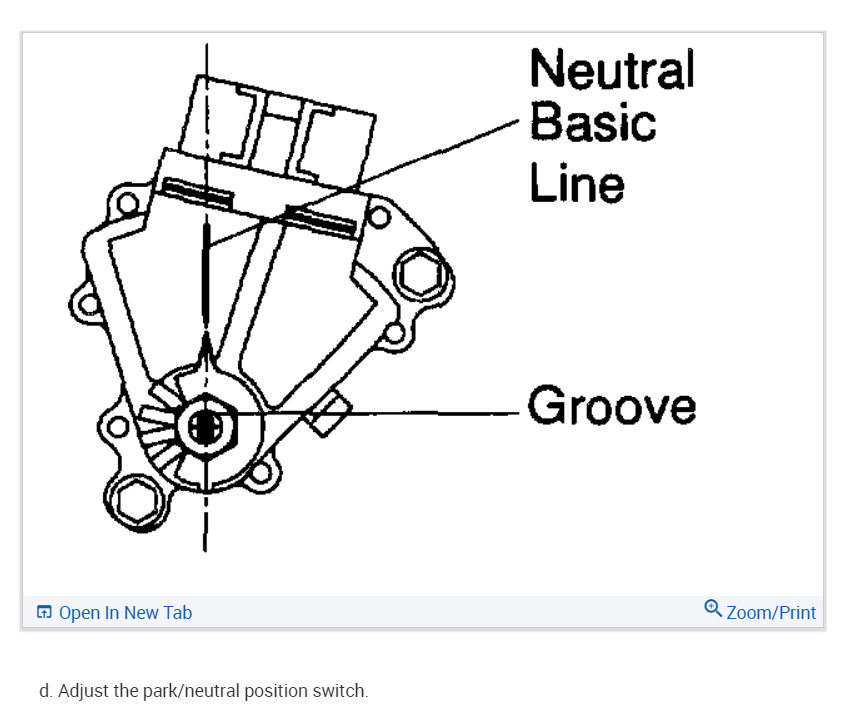

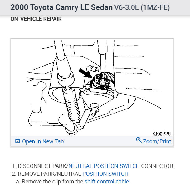

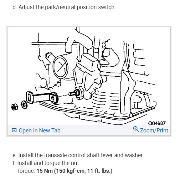

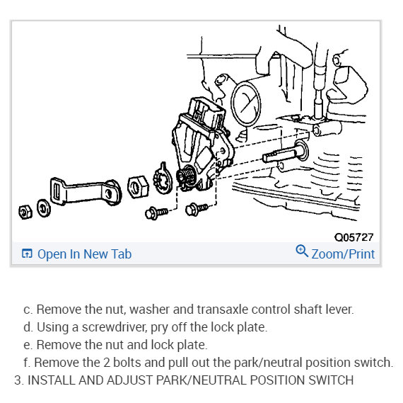

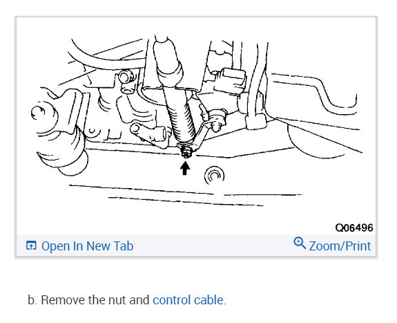

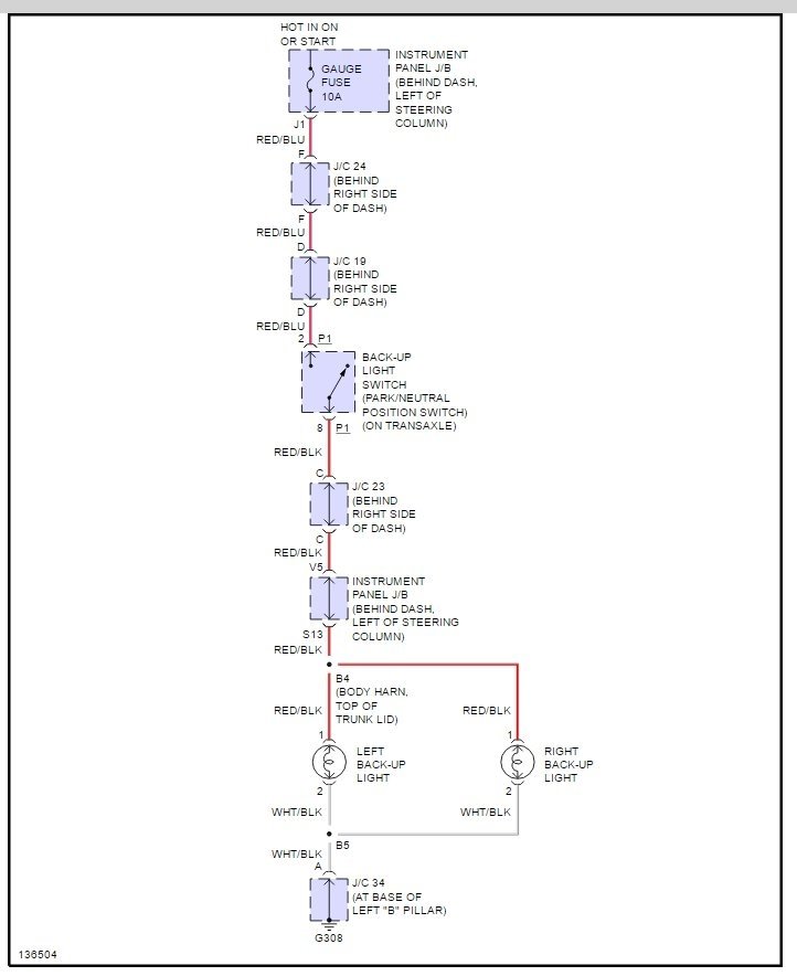

Check out 10-amp fuse labeled "GAUGE" in instrument panel junction box. If fuse is OK, suspect faulty back-up light switch (located on the transaxle). Here are diagrams to help you see how to replace the reverse light switch or gear range sensor (same thing) Check out the diagrams (Below). Please let us know if you need anything else to get the problem fixed.

I am trying to hookup a rear backup camera. I tied into the backup lights to power the camera and it works fine on my radio lcd screen when I manually go to the camera screen. However, I would like to cause the screen to switch automatically when I put the car into reverse. To do this I need to hook up the radio's "reverse" wire to the backup light power as well. I don't want to run another 15 feet of wire to the trunk to pickup this line. Is this wire available anywhere UNDER the dash or near the FUSE panel? I've searched the internet for camry wiring diagrams and gave up. Thank you for your help.
Nov 12, 2019 at 4:22 AM (Merged)
CARADIODOC
  • 34,369 POSTS
You can go to the neutral safety switch on the transmission. From there, the wire goes to a joint connector on the right side of the dash, then another joint connector left of the steering column. From there it runs to the back-up lights. That wire is red / black. Sorry that I don't have a drawing that shows those connectors.

Hey TONYMO123,
Check the system fuses first. Tail lights and plate light are on the same circuit and fuses so if the tail lights on then you need to check bulbs and socket and wiring as for the reverse switch.
Here is a guide and a diagram that will help you test the system and get the problem fixed.
