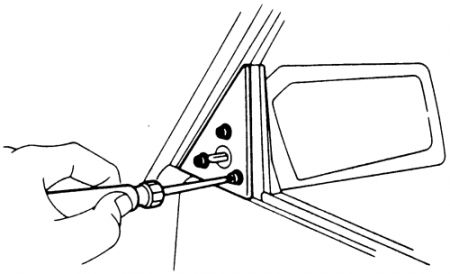

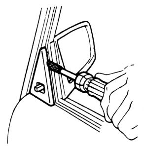

How do I replace the right rear view mirror? I have seen answers saying open door, you will see 3 bolts. I have that but they are no where near the mirror. Thanks for your help.
Jan 25, 2009 at 8:27 AM
BLUELIGHTNIN6
  • 16,542 POSTS
The mirrors on these models can be removed from the door without disassembling the door liner or other components. Both left and right outside mirrors may be either manual, manual remote (small lever on the inside to adjust the mirror) or electric remote. If the mirror glass is damaged, replacements may be available through your dealer or a reputable glass shop in your area. If the plastic housing is damaged or cracked, the entire unit will need to be replaced. MANUAL MIRRORS REMOVAL: Remove the set screw and the adjustment knob, if equipped. Remove the delta cover; that's the triangular black inner cover. It can be removed with a blunt plastic or wooden tool. Don't use a metal prytool; the plastic will be marred. ((Using a tapped ended tool to pry the trim from the mirror))
https://images.2carpros.com/forum/automotive_pictures/261618_0900c15280092b34_1.jpg
((Removing the three retaining screws from the inside of the vehicle to extract the mirror))
https://images.2carpros.com/forum/automotive_pictures/261618_0900c15280092b34_2.jpg
Depending on the style of mirror, there may be concealment plugs or other minor parts under the delta cover"”remove them. Support the mirror housing from the outside and remove the three bolts or nuts holding the mirror to the door. Remove the mirror assembly. INSTALLATION: Fit the mirror to the door and install the nuts and bolts to hold it. Pay particular attention to the placement and alignment of any gaskets or weatherstriping around the mirror; serious wind noises may result from careless work. Install any concealment plugs, dust boots or seals which were removed. Install the delta cover and install the adjustment knob, if it was removed. Cycle the mirror several times to make sure that it works properly. POWER MIRRORS Turn the ignition key to the OFF position. Disconnect the negative battery cable. Wait at least 90 seconds from the time the negative battery was disconnected to start work. CAUTION: Some models covered by this guide may be equipped with a Supplemental Restraint System (SRS), which uses an air bag. Whenever working near any of the SRS components, such as the impact sensors, the air bag module, steering column and instrument panel, disable the SRS . Remove the delta cover; that's the triangular black inner cover. It can be removed with a blunt plastic or wooden tool. Don't use a metal prytool; the plastic will be marred. Depending on the style of mirror, there may be concealment plugs or other minor parts under the delta cover"”remove them. Depending on the type of door trim, you may need to remove the door inner panel to access the electrical wiring harness for the mirror. Support the mirror housing from the outside and remove the three bolts or nuts holding the mirror to the door. If the wiring to the electric mirror was not disconnected previously, detach it now. Some connectors can only be reached after the mirror is free of the door. Remove the mirror assembly. INSTALLATION: Fit the mirror to the door and install the nuts and bolts to hold it. Connect the wiring harnesses if they are on the outside of the door. Pay particular attention to the placement and alignment of any gaskets or weatherstriping around the mirror; serious wind noises may result from careless work. If the wiring connectors are on the inside of the door, plug them back together and install any concealment plugs, dust boots or seals which were removed. Attach the door inner panel if removed. Install the delta cover and install the control lever, if it was removed. Connect the negative battery cable. Cycle the mirror several times to make sure that it works properly. Thanks for using 2CarPros.com!
