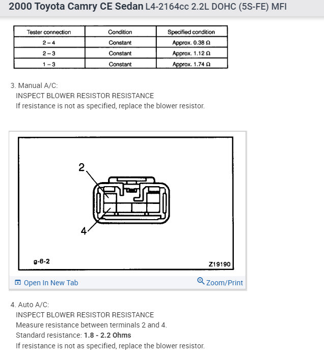

My blower fan only works on the high position. What could it be? If it is a relay, where would it be located at?
Wednesday, January 30th, 2008 AT 7:12 PM
SQM
  • 6,383 POSTS

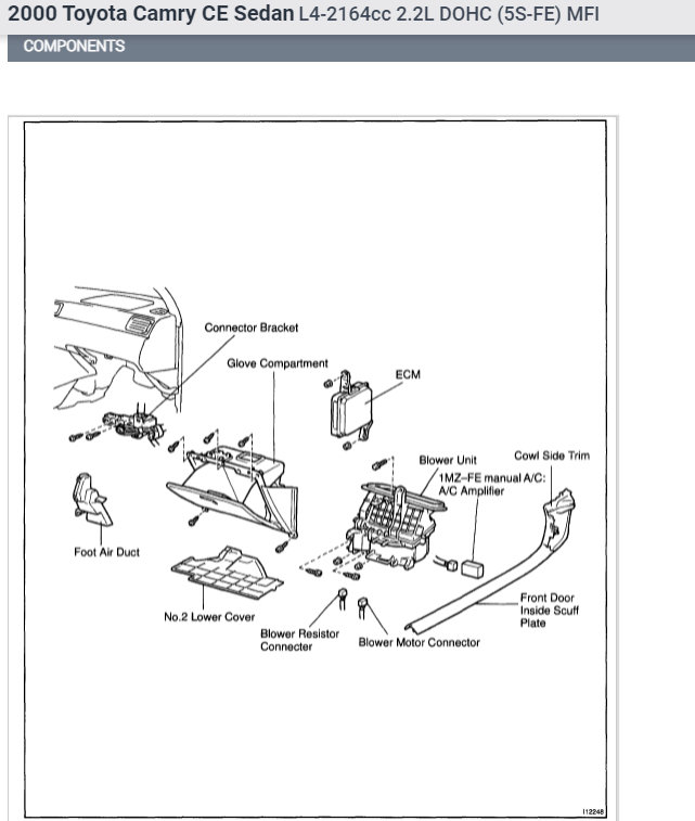

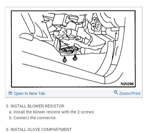

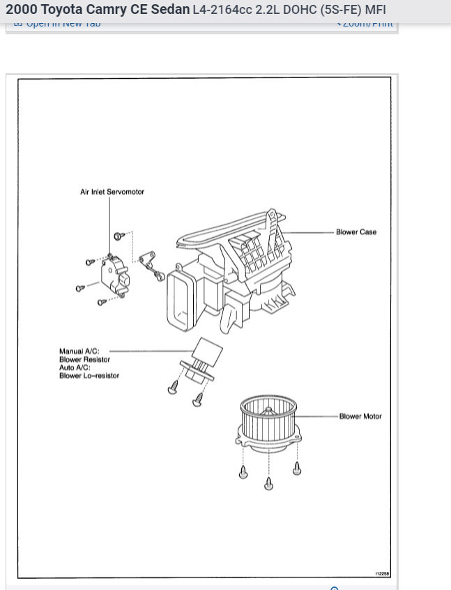

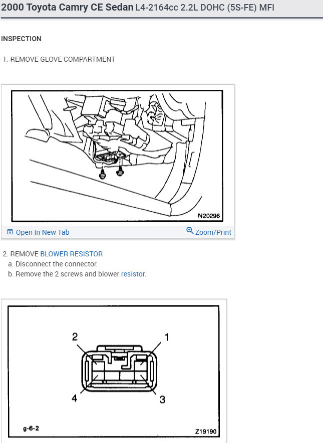

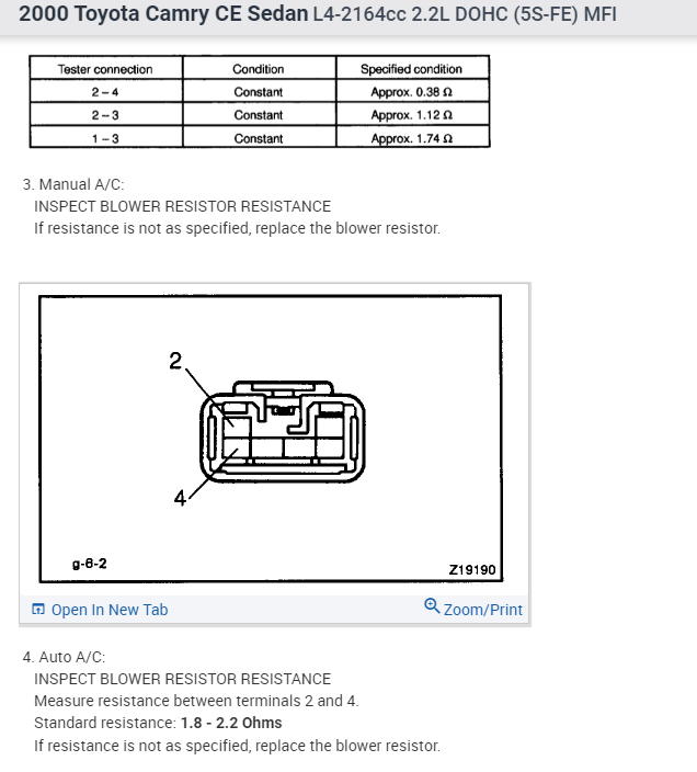

Sounds like you have an issue with the blower motor resistor.
The resistor is what controls the fan speed. Many times, when the resistor fails, it will only blow in one speed, typically in the highest setting.
The blower motor resistor is located on the blower motor housing. To access it you will have to remove the glove box.
