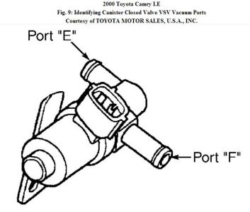

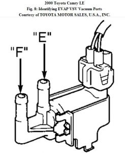

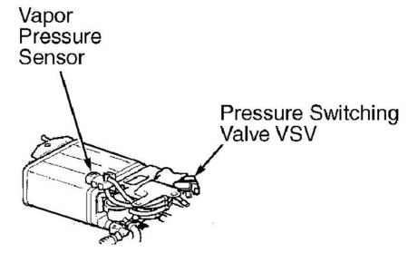

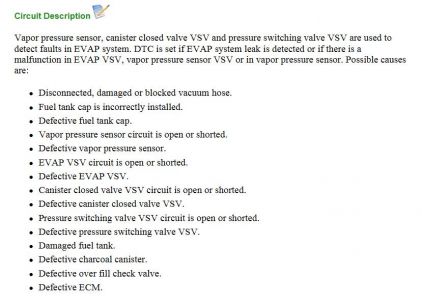

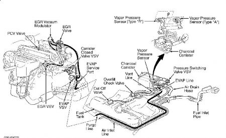

Here is a description of the possible causes and it is not caused by the gas cap. Most likely problem would be the VSV valve located are rear near to fuel tank. however it could be any of the valve suystems and the diagnostics are rather extensive. Would you like to do the diagnostics your self?
https://images.2carpros.com/forum/automotive_pictures/192750_VSV00Camry_1.jpg
DTC P0446: EVAP VENT CONTROL CIRCUIT.
https://images.2carpros.com/forum/automotive_pictures/192750_P0446_00Camty_1.jpg
https://images.2carpros.com/forum/automotive_pictures/192750_EVAPComp00Camry_1.jpg
Jul 12, 2009 at 8:52 AM
DOLEMITE44149
  • 17 POSTS
Yes, I would like to run the diagnostics myself if possible.

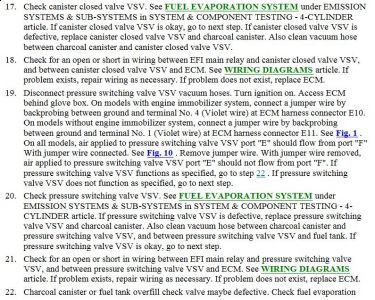

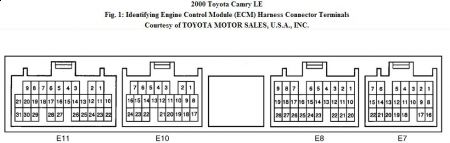

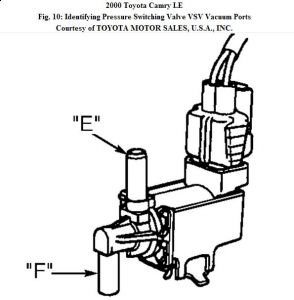

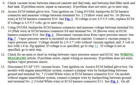

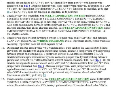

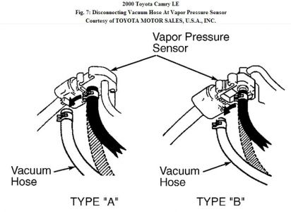

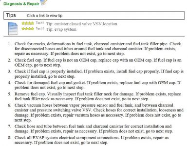

Here are the diagnostic procedures.
https://images.2carpros.com/forum/automotive_pictures/192750_P0446_00Camry01a_1.jpg
https://images.2carpros.com/forum/automotive_pictures/192750_P0446_00Camry01b_1.jpg
https://images.2carpros.com/forum/automotive_pictures/192750_P0446_00Camry01c_1.jpg
https://images.2carpros.com/forum/automotive_pictures/192750_P0446_00Camry01d_1.jpg
https://images.2carpros.com/forum/automotive_pictures/192750_P0446_00Camry01e_1.jpg
https://images.2carpros.com/forum/automotive_pictures/192750_P0446_00CamryFig01_1.jpg
https://images.2carpros.com/forum/automotive_pictures/192750_P0446_00CamryFig07_1.jpg
https://images.2carpros.com/forum/automotive_pictures/192750_P0446_00CamryFig08_1.jpg
https://images.2carpros.com/forum/automotive_pictures/192750_P0446_00CamryFig09_1.jpg
https://images.2carpros.com/forum/automotive_pictures/192750_P0446_00CamryFig10_1.jpg
Jul 13, 2009 at 3:47 AM
DOLEMITE44149
  • 17 POSTS
Perfect! It worked! Thank you for your advice.
