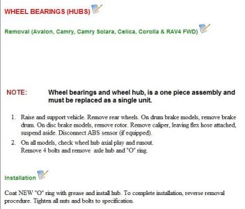

I have a 99 toyota camry the wheel barring on the rear i'm wanting to know how it comes apart like is it pressued plated together do u know were I can fine a digram or send me one thank u

https://www.2carpros.com/forum/automotive_pictures/261618_Noname_1905.jpg

How would u do it if u just have the whell barring can u show me a digram to see how it comes apart or like the step after u take the abs sencer off does it have to be pressed on and off

Does your car have ABS or not equipped with it? If it has ABS then you have bought the wrong part, because the ABS style rear wheel bearing can not be separated, you must purchase the entire hub. If it is not equipped with ABS than you have to use a bearing puller to separate the bearing from the hub.
