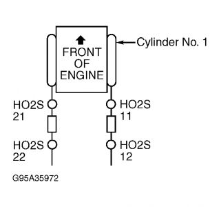

i just bought a 1999 camry v-6 le and i cant find anything in the manual about the transmission service are these cars have a no service transmissions car runs fine no problems transmission oil a little dark is there drain plug in this car to change oil only also where is the 02 sensor 1 bank 1 located

NOTE: All transmissions contain a transmission oil strainer mounted on the valve body. Manufacturer does list transmission oil strainer replacement when servicing the transmission. If servicing transmission oil strainer, oil pan removal is required Raise and support vehicle. Drain transmission fluid into proper container. If replacing transmission oil strainer, remove transmission oil pan and gasket. Fill transmission through dipstick tube to specified capacity using recommended fluid(Dexron-II or Dexron- III ATF )
